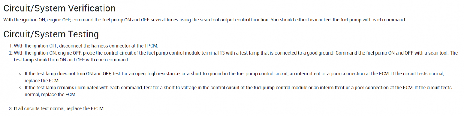

I have a P0230 code. We have voltage on pin 13. It's my understanding that this result means I may have a bad ECM
It does look like that wire is a straight shot from ECM.. (passes through one connector somewhere)
Could be why they bypassed the fscm in the first place (bad ECM)
