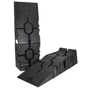

Is there a reason you only want to lift one side at a time? You CAN do all the work with the truck on the ground if you fit, or drive up on ramps. (I use Rhino Ramps, or whatever AutoZone sells, for extra clearance, but I can fit under the vehicle without lifting it up.)

Just get some ramps.
