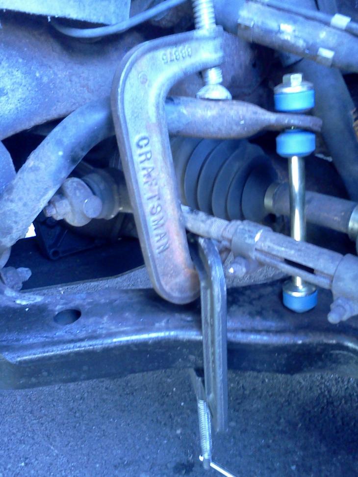

UPDATE!
Finally got the links on and shock bolt out! woohoo!
The bolt was still extremely tough but turned because of the PB blast soaking in it over night.
The trick that helped me get those damn links on was using c clamps to squeeze the sway bar down. I didn't have a large enough clamp so I used 2 of them as you can see in the pic. Works awesome and compressed those bushings like nothing. The other trick is to jack up the rear of the truck to put weight on the side you are working on. Say you are doing the left front links you jack up the rear RIGHT to put weight down on the control arm.
Jacking up the control arm does not work because the torsion bar prevents it from moving up.
So far this job and replacing the drivers side outside door handle was extremely stressful but DONE:head3: Now my window comes off the track:fca5278d:
p.s. the shocks i put it were from the junk yard for $9 each worth a shot to me. These looked real good and anything is better then what I had! The pic shows the junk yard shock next to the rotted original.
