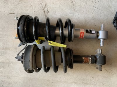

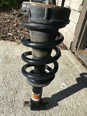

My '15 Tahoe LTZ w/Magneride shocks was purchased at 36k miles and did NOT pass ME state inspection due to leaking front shock. Under the Certified Pre-Owned purchase agreement I was able to get Chevy to replace the single front MRC. However, at 54k miles the other front MRC started to leak and I was quoted $1600 to replace both the front MRCs by Chevy dealership.
I personally wanted to improve my off-road capabilities (bigger, better tires / more clearance, etc) and went with Xineering's GM Shock Sims product for the Magneride delete. This product was born out of Max's passion for automotive tech and racing. The Corvette comes stock with Magneride and the racers need to delete that system in order to improve their track suspension. Max created the GM Shock Sims product out of that need. Since the top trim Tahoes, Burbs and Yukons are equipped with the same MRC as the 'vette, Max and Xineering marketed the product to those users as well. They actually have a fair amount of dealerships using the product to offer lifted trucks/SUVs on the lot.
Long story short, I did both front and back MRC replacement, so installed 8 sensors all together. Basically, the Xineering product tells the computer that the MRC is operating normally and allows you to install any coil/shock combination that fits your fancy, and vehicle. I am running Fox 2.0 Coilovers (adjustable, but mine are set for +2.25" ride height). They ride AMAZING compared to how poor the Tahoe rode with the MRC shocks.
But if you look at the OEM coilover setup vs the Fox coilovers, it's pretty easy to see that the ride should be better. Straight physics there...not to mention superior shock technology.
My Fox 2.0 Front Coilover (prior to install) OEM Magneride
OG Fox Shock.JPG 2014-2017-OEM-MagneRide-Front-Strut-Chevy-Silverado-Tahoe.jpg
Check out this thread - he did exactly what we're talking about here
