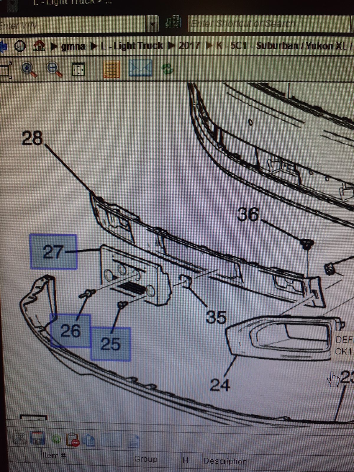

your missing this piece and also probably a different front bumper trim pieces. looking at the bumper trim it looks like there is a full length trim panel and ??maybe?? shorter 2 pieces to allow that to be installed. lower edge of the bumper cover should have a full length pieces that goes into the bumper cover. behind that appears to have provisions to attach this.

This may be a silly question and I admit I haven't looked at it too close but here goes:
My daughter just bought a 2017 Yukon XL and when the new license plates came in I put the rear one on - no problem. Went to put the front plate on and there isn't anyway to mount it - no bracket, no screw holes, nothing. What am I missing?
GM#22948151 $40.92
Bracket#27 includes #25-26
May also need #35 if not there.
