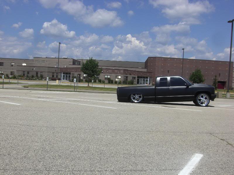

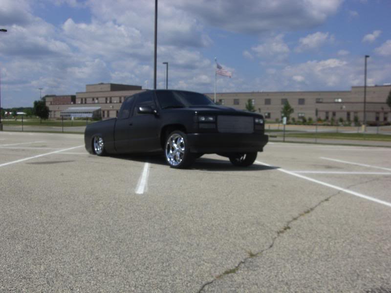

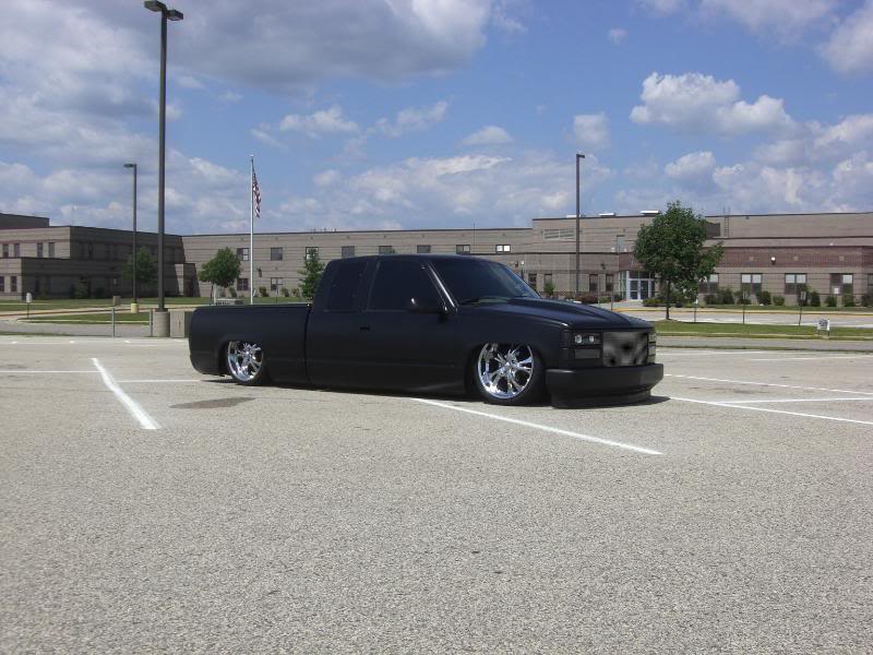

ya you would never be able to get that much movement from the front end...here is my last truck fully lifted and lowered with drop spindles..it was set up to get the most possible travel...when i layed frame, the bag was completely bottomed out..not really any way to do what you are wanting unless you had a straight axle like stated...then you run into other problems..theres a limit on suspension travel...
now an idea i always thought of..put the body on bags like a semi..then you can drop the body down over the wheels more then you could with just suspension
full lift at 200 psi, bag fully expanded and everything was clearanced to not hit
