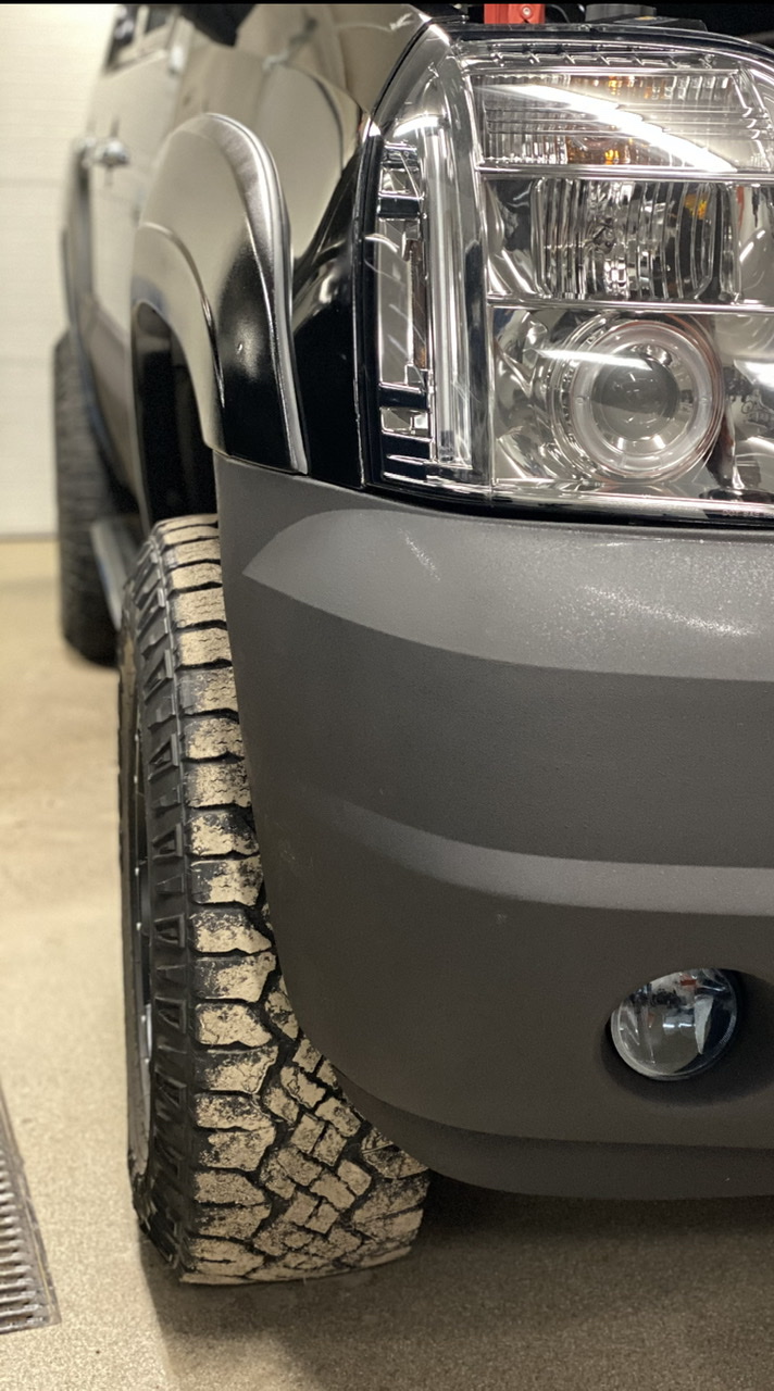

Since I was too cheap to buy new wheels with the correct offset, I simply used a 2” HUB centric wheel spacer to achieve the aggressive look. I believe I have a 2” lift and I had to perform the NorCal Mod along with remolding the front of the fender as it was rubbing badly.
Here’s the “NorCal Fender Mod”....
https://norcaltruck.com/2007-5-2013-chevy-gm-large-fender-mod
Here’s a picture of what had to be done in the front...

I would assume even with a 4” lift that your nearly 33” x 11.22” tires and a 2” spacer would hit the front clip as mine are very close to hitting it with 265/70/17 tires and the 2” spacer.
The thing to do is lift it first, drive it for awhile to let things settle, and then do any wheel/tire modifications.

So I measured the distance from my 265/70/17 tires (with a wheel offset of +24 and a 2” spacer) to my front clip and it’s 1” left to go before I hit it (while turning). I’m only saying this to give you sort of an idea as all trucks are different.
