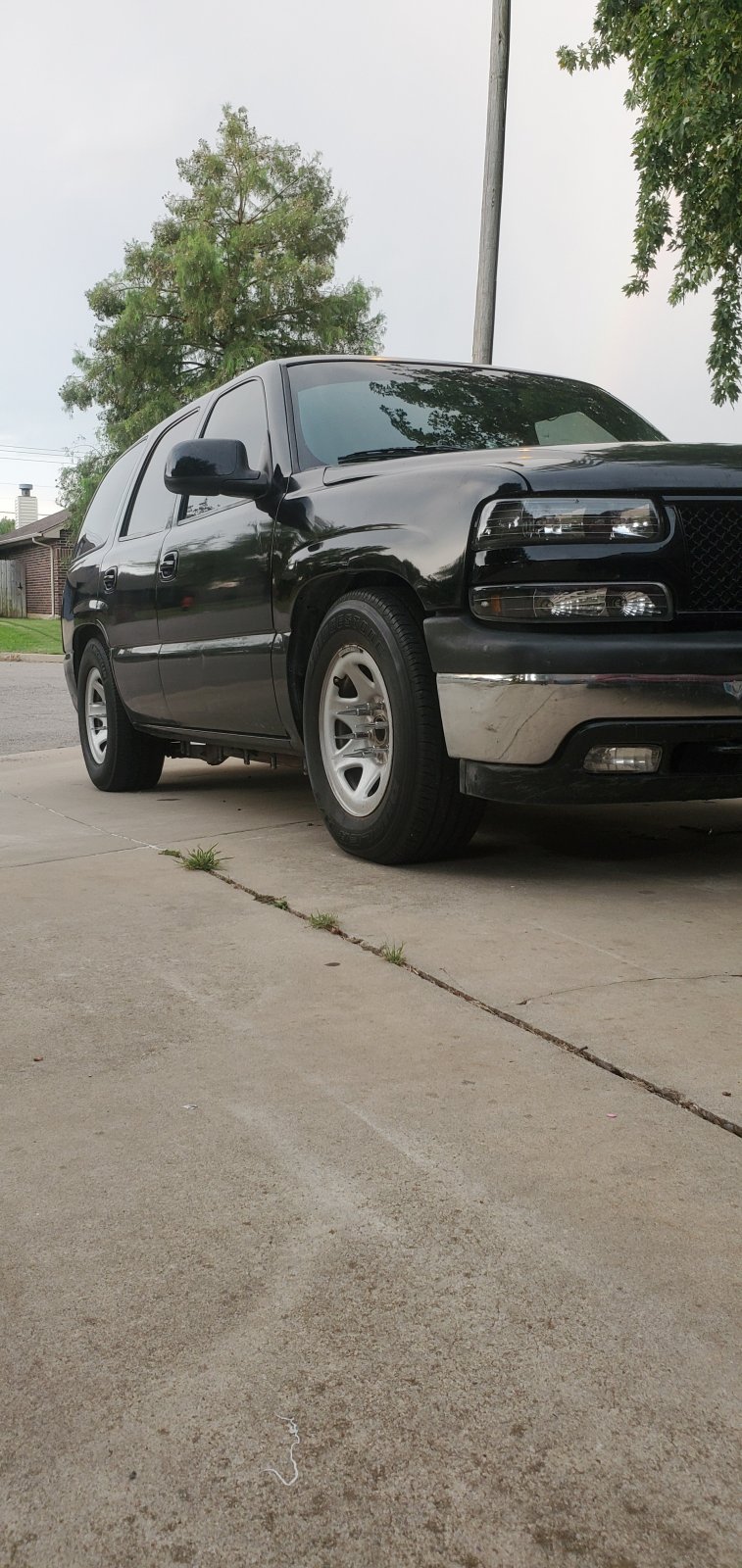

Previous owner hacked off the front bump stop cups and I am having a helluva time find some sort of replacement to bolt In. Truck is an 01 Tahoe with belltech drop spindles, Purple Keys and Stock replacement shocks. The front end bounces really bad and sways when going over bumps and dips. Looking to fix asap. Suggestions?
