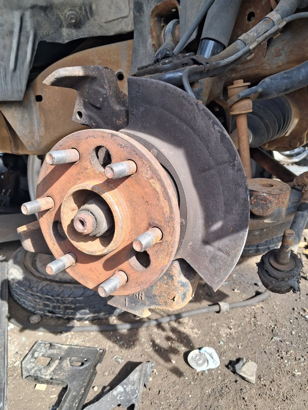

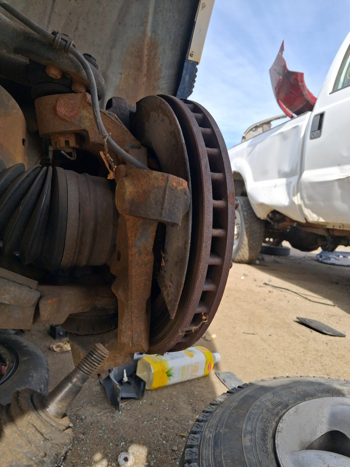

Just for reference I saw these on a '98 Tahoe today at the UPull; they are pretty solid. Do these look like the correct ones? VIN 1GKEK13R7WJ712240. I'd have pulled them but didn't have a 3/8" Allen to pull that left caliper; I'll need to pick up one.
