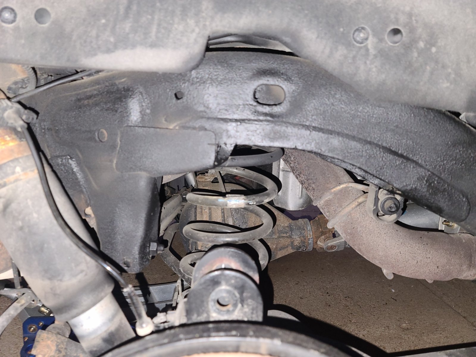

On 2015 + on passenger side there is extra bracket for panhard bar. How much did you guys cut of bumpstop bracket into panhard support bracket or did you just stop at edge
Here is pics where i stopped cutting

I trim just enough to clear the axle travel. No reason for any additional
