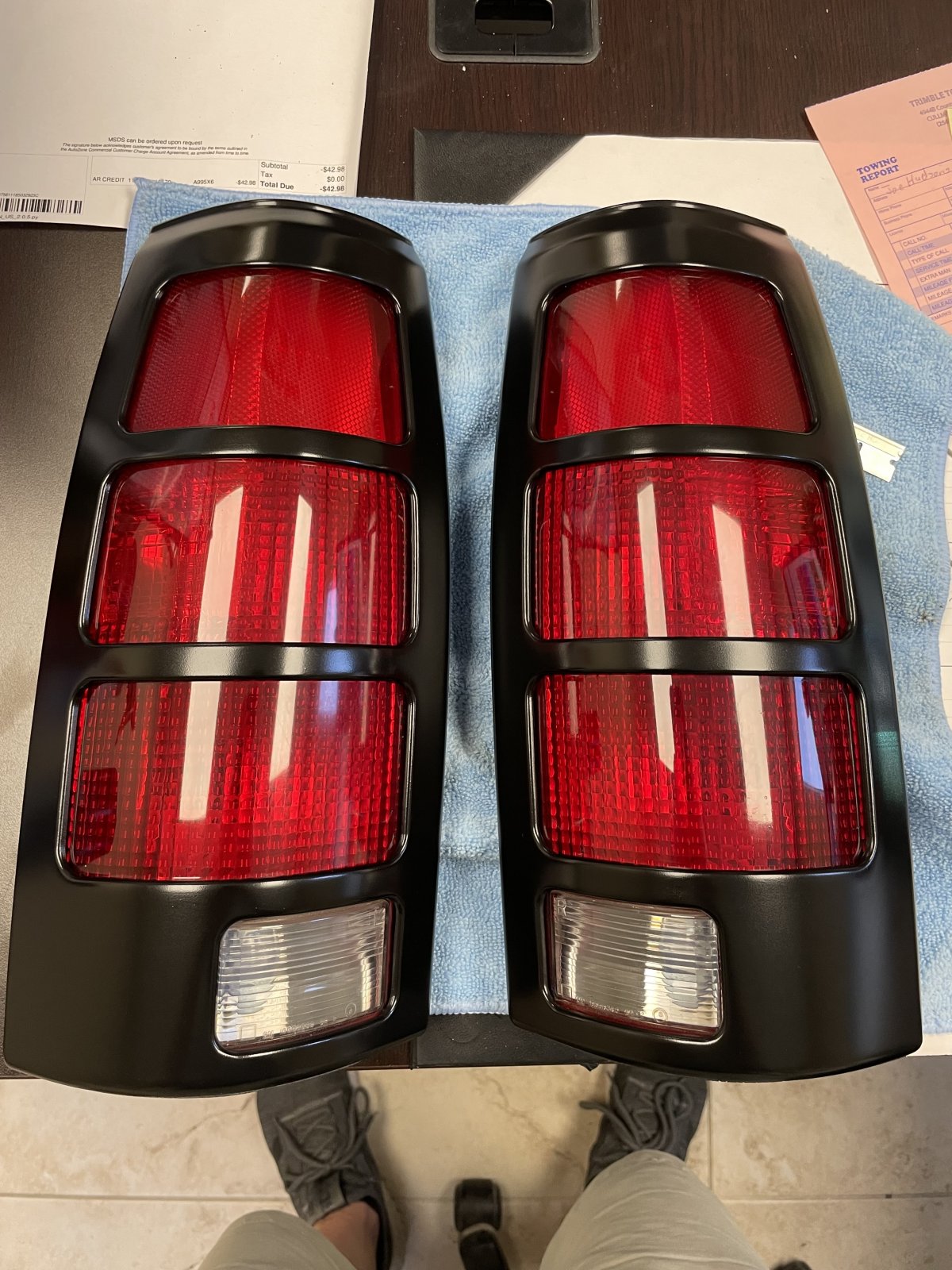

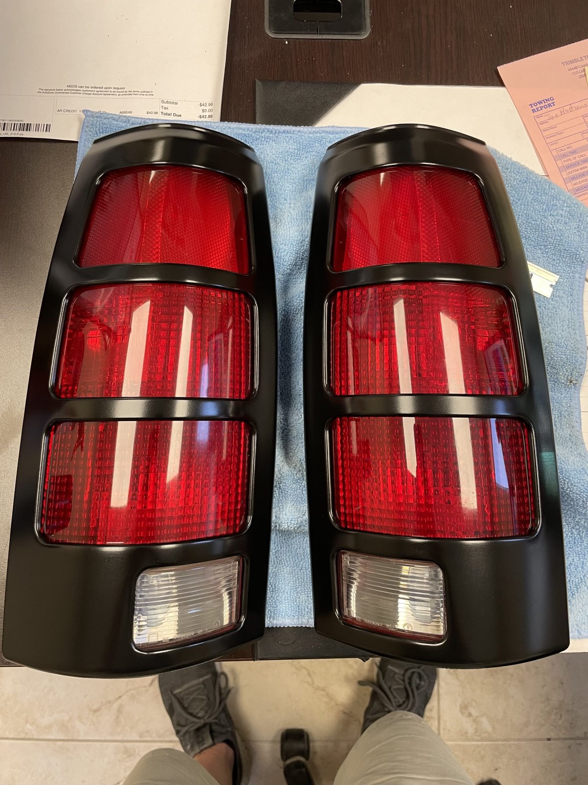

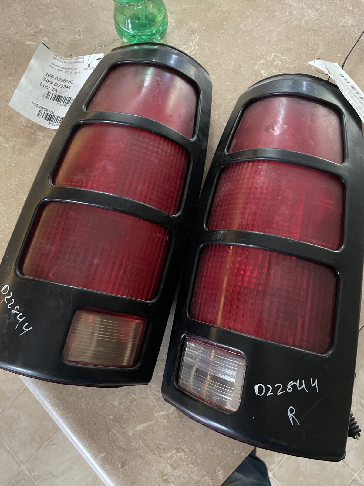

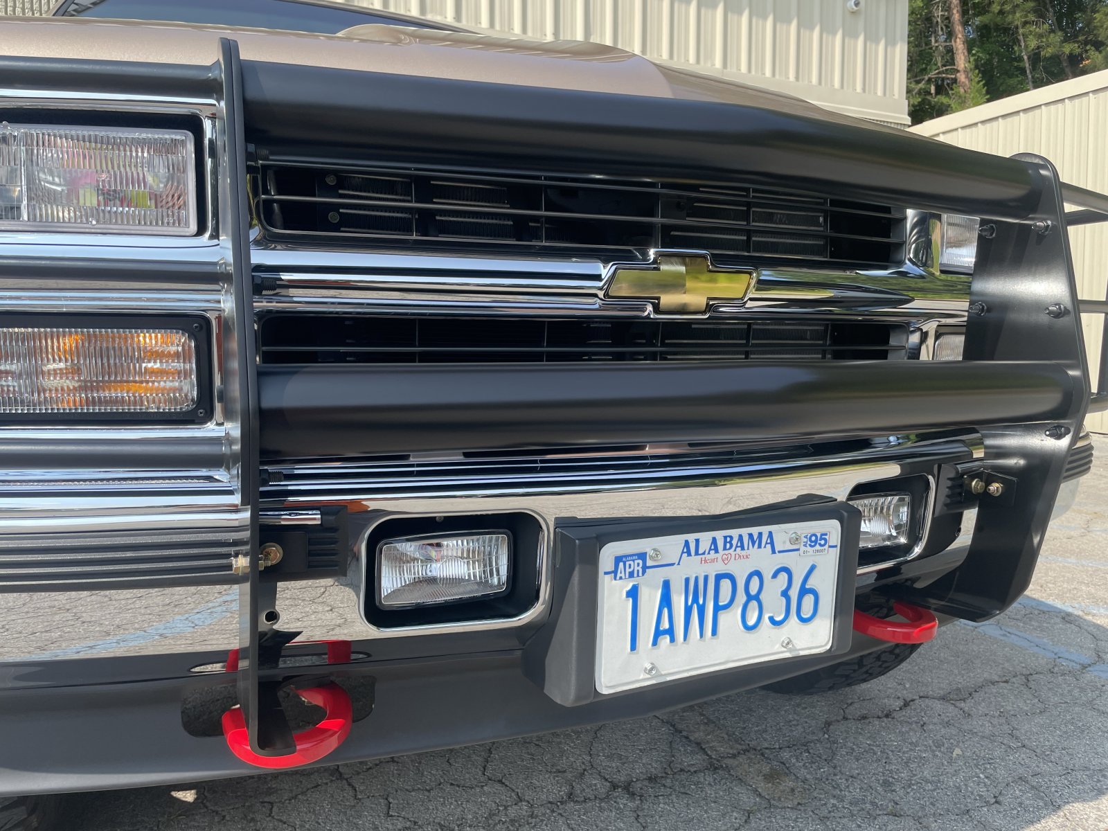

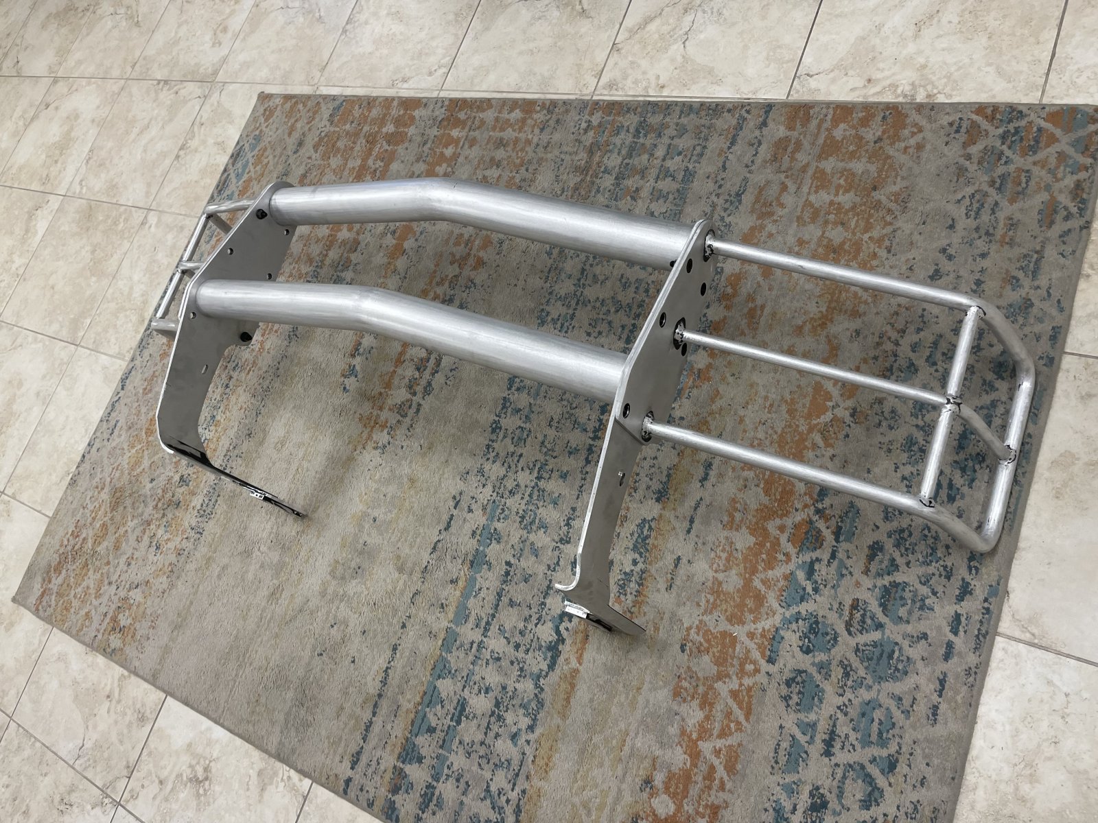

Found a set of OE Z71 tail lamp covers in a salvage yard in CT. Found a Z71 brush guard on Facebook marketplace attached to a Silverado for sale. Bought the lamps just for the covers but restored the lights too and decided to use them. Already had the foglamps/bezels/harness/switch for the Z71 lamps. Stripped and straightened the brush guard and working on getting it coated for final install. I’ve been wanting to build the truck Chevy should have built but never did. The 2-door Z71.

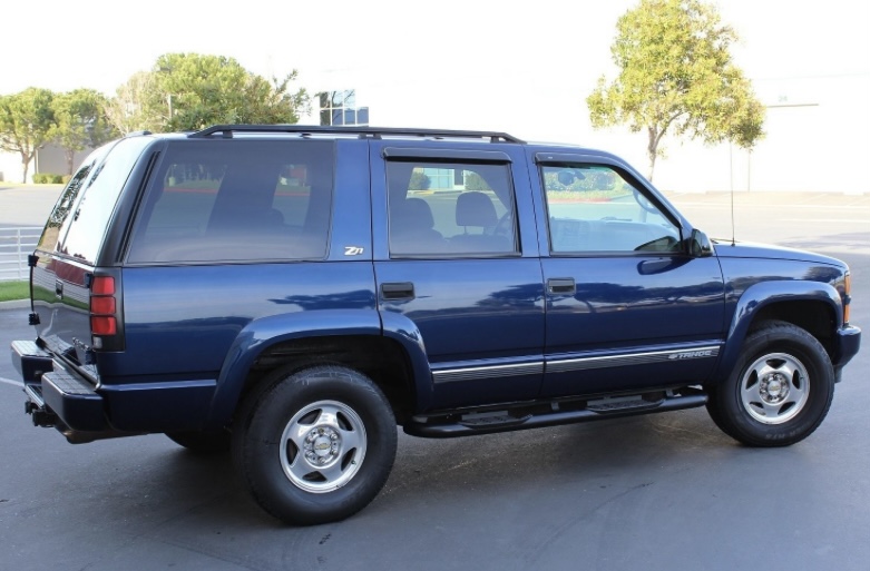

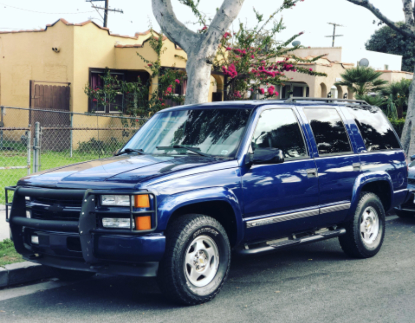

Yup. I remember those. I had a buddy with one. IIRC, it was a single year deal. His was a very nice looking dark blue.

You made a big difference in those tail light lenses. If you don’t mind me asking what did you use to get rid of the haze they did have. They look good.
Yeah this is a lot easier than you think. Once cleaned up and the covers removed, I wet sanded them with 1500. Cleaned them off and then wet sanded with 3000. I have a little 3” mini buffer and used some compound to take out the 3000 scratches. Polished with some finishing compound. That’s it. No clear or anything like that. Just remove the 23 years of oxidation and start fresh. I had originally planned to trash the lights because all I wanted were the covers. Then I decided to clean up the lamps to sell, but once I saw how they came out, I replaced my new aftermarket lamps with restored OE.

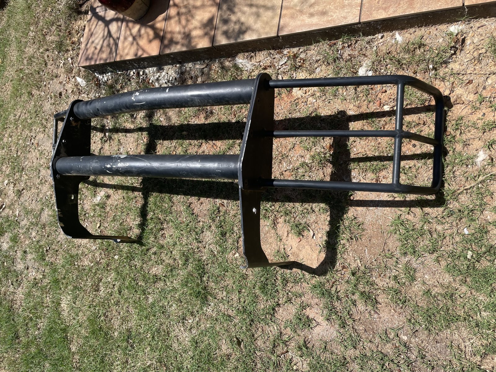

I’ve gotten the brush guard in primer and just have to fix a few knicks here and there. Decided to replace ALL of the hardware since the threads are corroded (these things are notorious for galvanic corrosion). Should be able to put it back on the truck with some pics next week. Fabricated some nice little brackets to the bumper that were missing and fixed a hole the prior owner drilled . This is normally the type of thing I rush because I want instant gratification but I figured it’s the last one I will ever own.

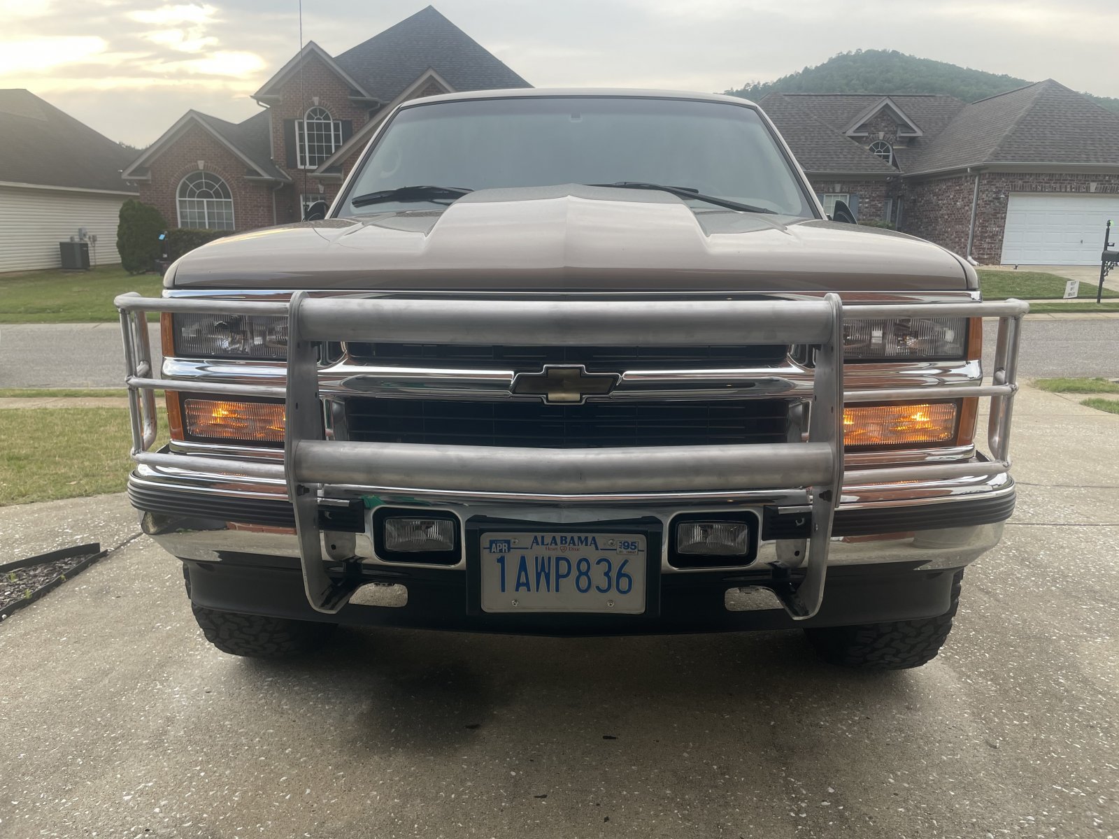

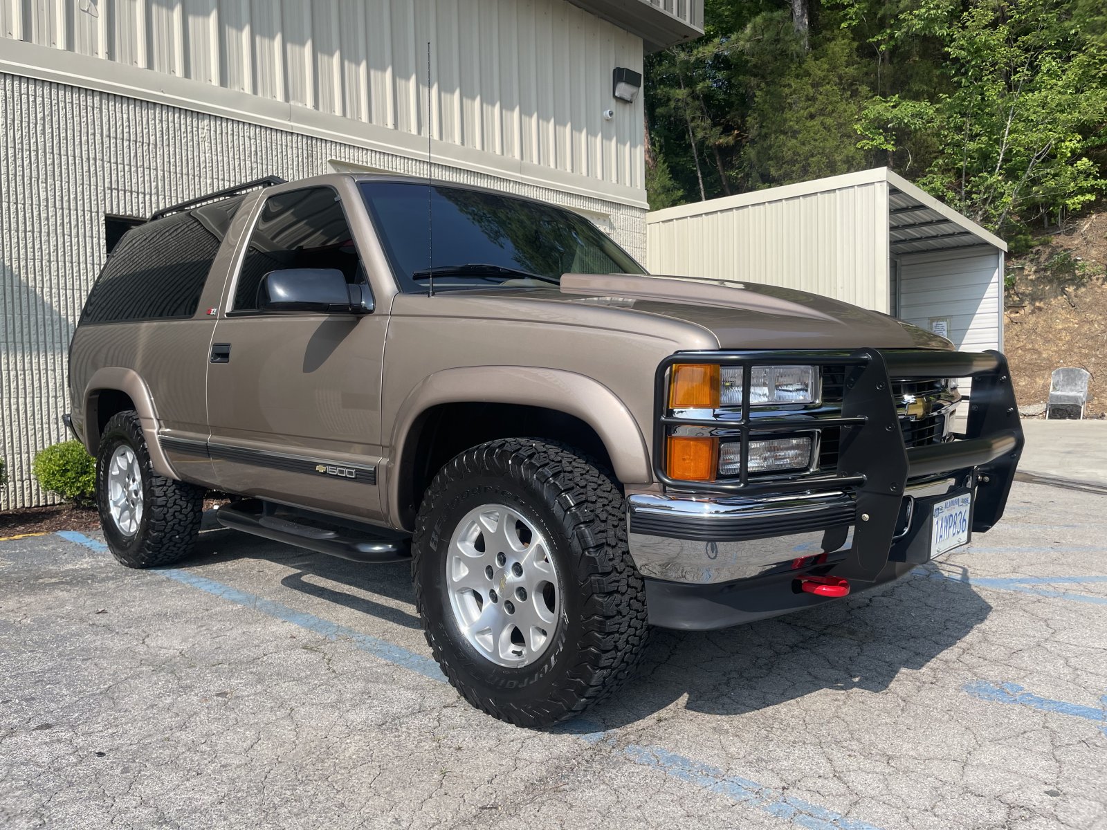

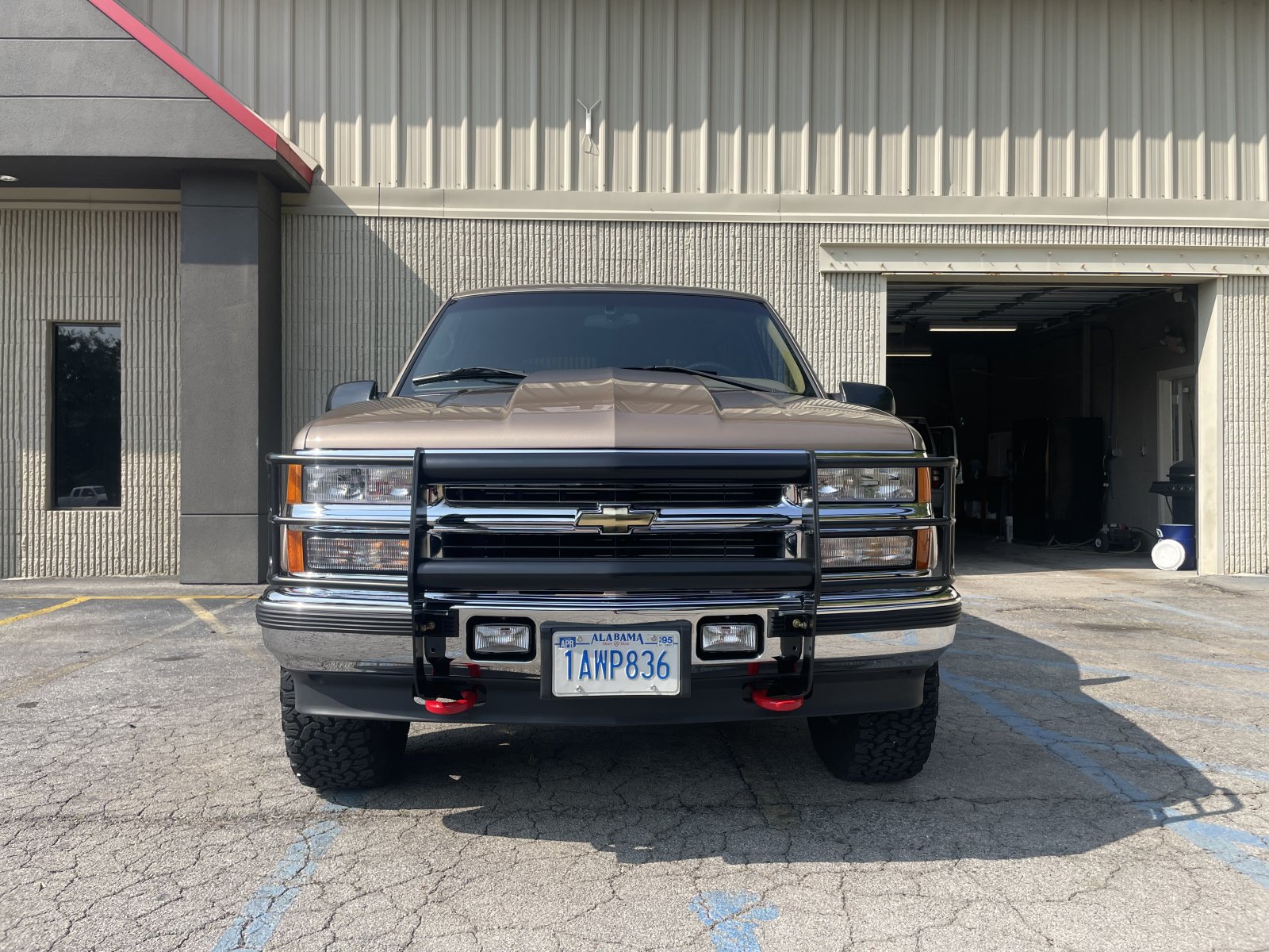

Got it all buttoned up today! Lots of patience paid off. Found all new hardware at McMaster-Carr. Highly recommend them as you can find any kind of fasteners there at good prices and delivered next day. Turned up the torsion bars a bit to level it out. I will be on the hunt for the painted bumpers but I’m satisfied even if I never find them.
