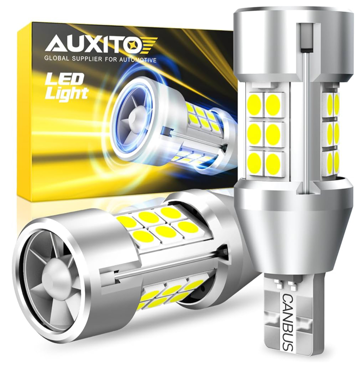

I finally found an LED Reverse bulb replacement that works in our 2021 z71 Tahoe without a resistor or modifying wiring. These Auxito 2024 921 with built in fan do not cause a bulb out warning for me. The fan is somewhat loud and can be heard when outside the vehicle and a faint amount while in but not enough to bother me, especially for the short amount of time they are on. https://www.amazon.com/dp/B0CL3TDH61?ref=ppx_yo2ov_dt_b_product_details&th=1

Thank you for posting this. I can confirm this bulb works with no issues or errors. I installed yesterday in my 2023 Suburban RST and ordered another set for my wife’s 2023 Tahoe.

Good find. The fan is the key because it’s presenting the load needed to trick the BCM into thinking there’s an incandescent bulb in there.
Motors are one of the biggest electrical consumers of power. Forget running resistors on aftermarket LED, hook up a micro-fan in the circuit.

Just a heads up for anyone who bought these. I have had a few problems with these lights. The “Check Reverse Light” message appears, and the screen is blank. It's the same issue everybody has when changing out these bulbs. These do work 98% of the time. If these go out, I’ll buy the Recon Taillights instead. I am tired of dealing with these bulbs.
