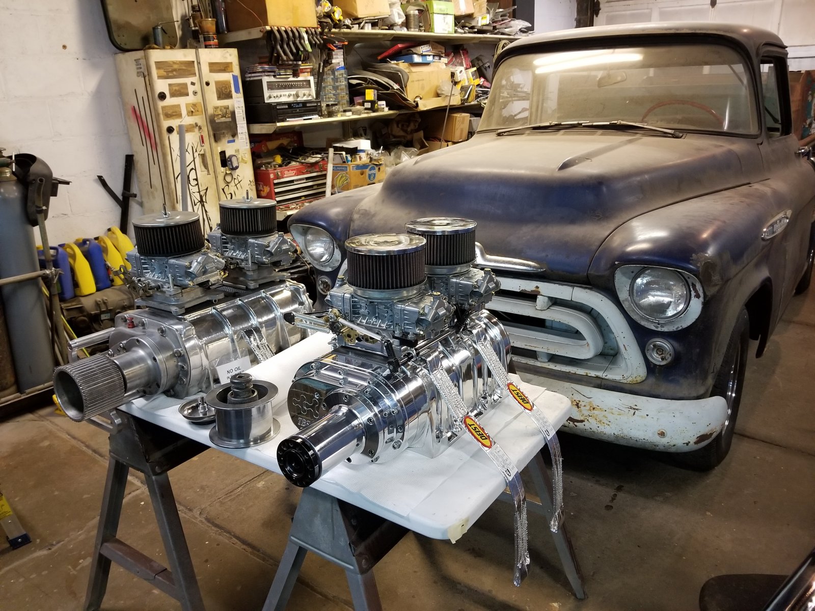

Yes, right now my heads are the restriction, as it was in the video the blower and the heads were to small, I had to spin it at 8% over to get the 3 lbs. I eventually went to 12% over but naturally fought some cooling issues, my axles were also undersized and thankfully it just blew the 19.5 wide tires right off. Last year I decided I'd like to feel the power instead of just hearing it, so I went to a bigger blower, whole new fuel system from cell forward and upgrading to 35 spline axles and bigger carrier, brakes , radiator and will get stickier tires.
On paper it should be close to a thousand horse with the new setup at 6-8 lbs, of course there's no way to predict boost gains with temperature gains but should be close. What am I gonna do with that on the street...have fun...lol

Belts are more prone to "jumping off" with sudden changes in throttle like you have on the street or track. A damper pulley helps tame that.

I don't believe you know how big the lip is on the tensioner pulley, I don't know of anyone that has had a belt "jump off" and I have a lot of friends with roots blowers. You can see the tensioner in between the two blowers.
