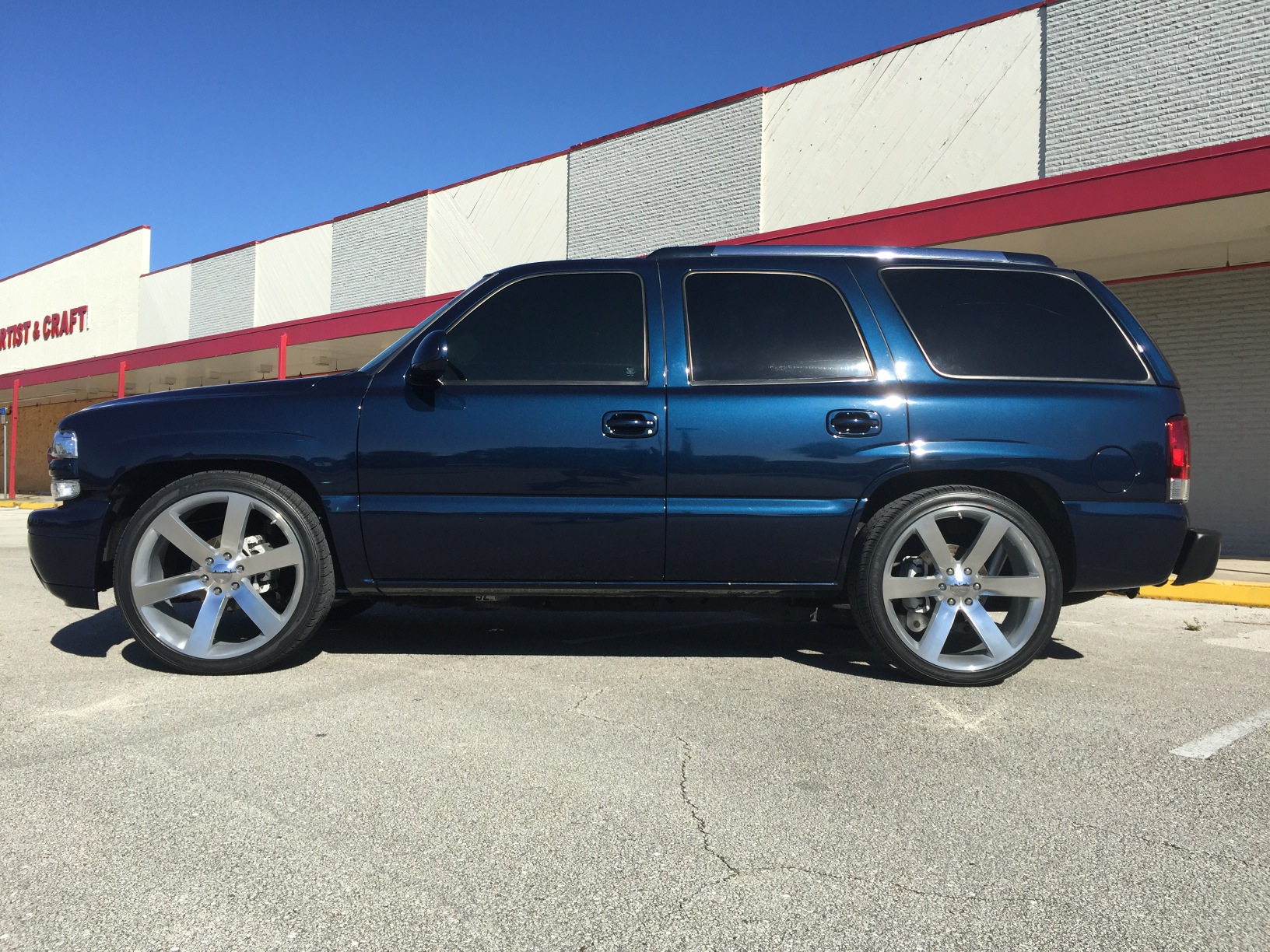

Super clean without the hitch....if you don't tow then leave it off IMO
Looks real good, Only thing I had a hard time with mine, Is that you could now see the Differential Cover and that really bugged me as to
A. I need to be lower
B. Now I need a custom
Differential Cover something like polish
I Swear I have Serious Problems, I think Im gonna remove my Wiper. now.
@Travieso
Yes! Remove that wiper now. So clean without it. Yeah not sure about the differential cover. Simple Green'd quite a bit under there yesterday to paint up some of the surface rust and all areas. Not sure I will go as far as a custom cover, but maybe at least clean it up......and you know that no one other than TYF members are getting down on their knees to check your diff cover to see how rusty it is. Having said that I did wash the shocks and pan hard bar so that the silver and red are clean. Go figure.

lol mine being lifted the diff cover drives me up the wall! it is clean and painted but you can see it. when I get around to converting to rear disk I will be swapping the diff cover as well! if you cant see yours I see no need for it

That is why I am happy being lowered. The dirty frame constantly visible would drive me crazy, but being higher than everybody is that tradeoff. So for now, she will be a pavement pounder dodging potholes and curbs.

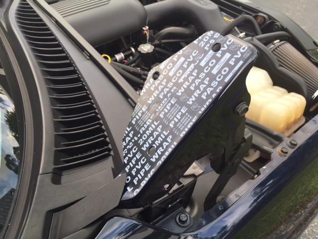

The second round of paint for the HD Hood has finally been completed. I picked it up yesterday after 3 weeks of waiting for paint to arrive, prep time and extra off gassing time. We let it sit and breathe in a dark corner of their shop for a week. Hopefully no reaction this time.
I had them spray the hinges in the booth as well to get them super glossy with clear coat. Might as well have them match the perfection of the hood this time.
As well, I decided to put a gasket between the hinges and the hood as they meet metal to metal upon installation once you screw them together with the 3 bolts on each side.
I used the Pasco 9062 2" x 50 ft 20mil Adhesive Pipe Wrap Tape. We use this stuff on the boats all the time to isolate metal parts that would otherwise not have a gasket to help prevent corrosion or vibration issues. I had some left over from projects this fall, so a few strips, a sharp razor blade and instant gasket. Love this stuff.

Fits nice and tight now that the hood is mounted. Here's a few pics.

good idea on the pipe wrap. what is the texture like on it? we used 5mil adhesive backed felt at the body shop on the nice rides. it worked very good but didn't hold up very good if u removed the hood again :(
Thx man.
This pipe wrap is vinyl with adhesive back. Super sticky. It stretches when you pull it off the roll, but goes back to shape. As said, we use it all the time on the boats to gasket metal parts. The adhesive makes it a no brainer to easily apply to the parts without having to use additional adhesives.
A new razor blade works best for trimming and I used an Exacto knife for the bolt holes. Here's a link directly to their site. Pretty much impervious to anything normal. Different widths and mils.

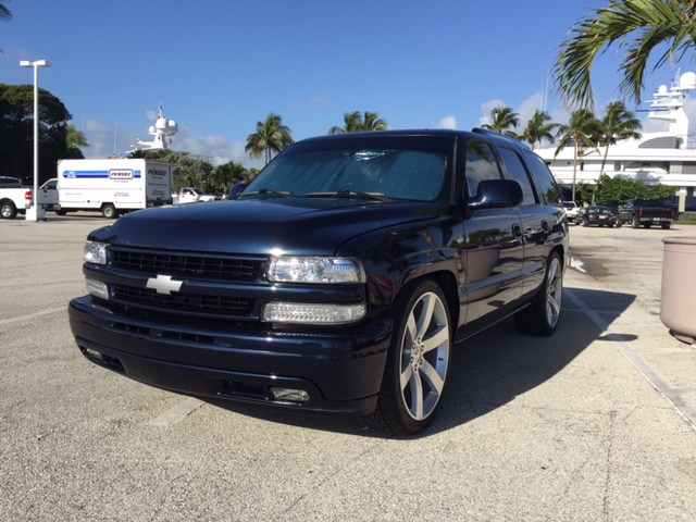

Yes ******* indeed, big fat juicy *******. So fine!!!
Only missing one thing....
And did i miss the antenna delete part? Or was there one ?

Such a sexy *****. i think it's mostly the palm trees in the back and the warm looking pics that make it look much better. Jk just jelly of your weather

Palm trees always makes everything look better ^^^

Thx man. Yessir.. cannot beat the weather this week or this time of year for that matter. The beaches are packed with lots of ***** white snowbirds. That was out to a new taco bar for lunch with the wife after installing the freshly painted HD.
