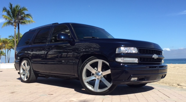

How cute going to the beach in the winter. My truck is sitting in the garage a bit dirty haven't had a chance to wash it.

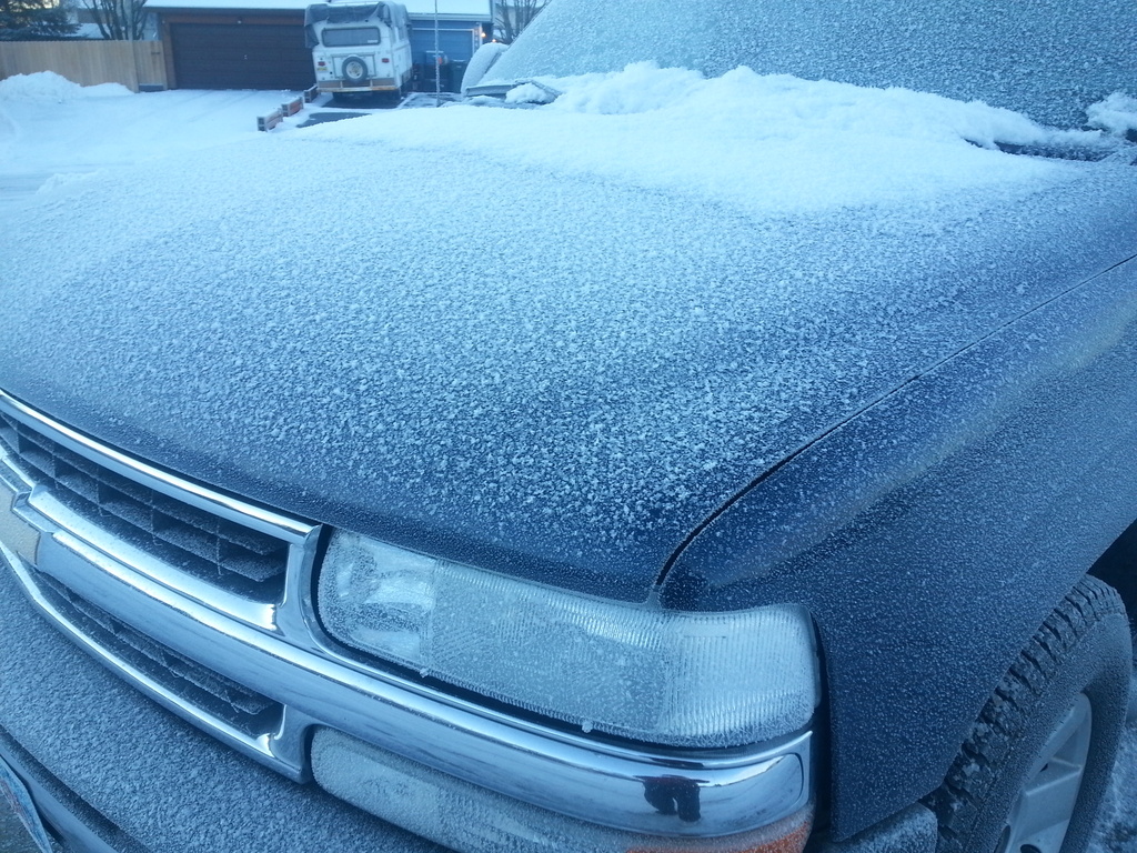

Mine here in alaska

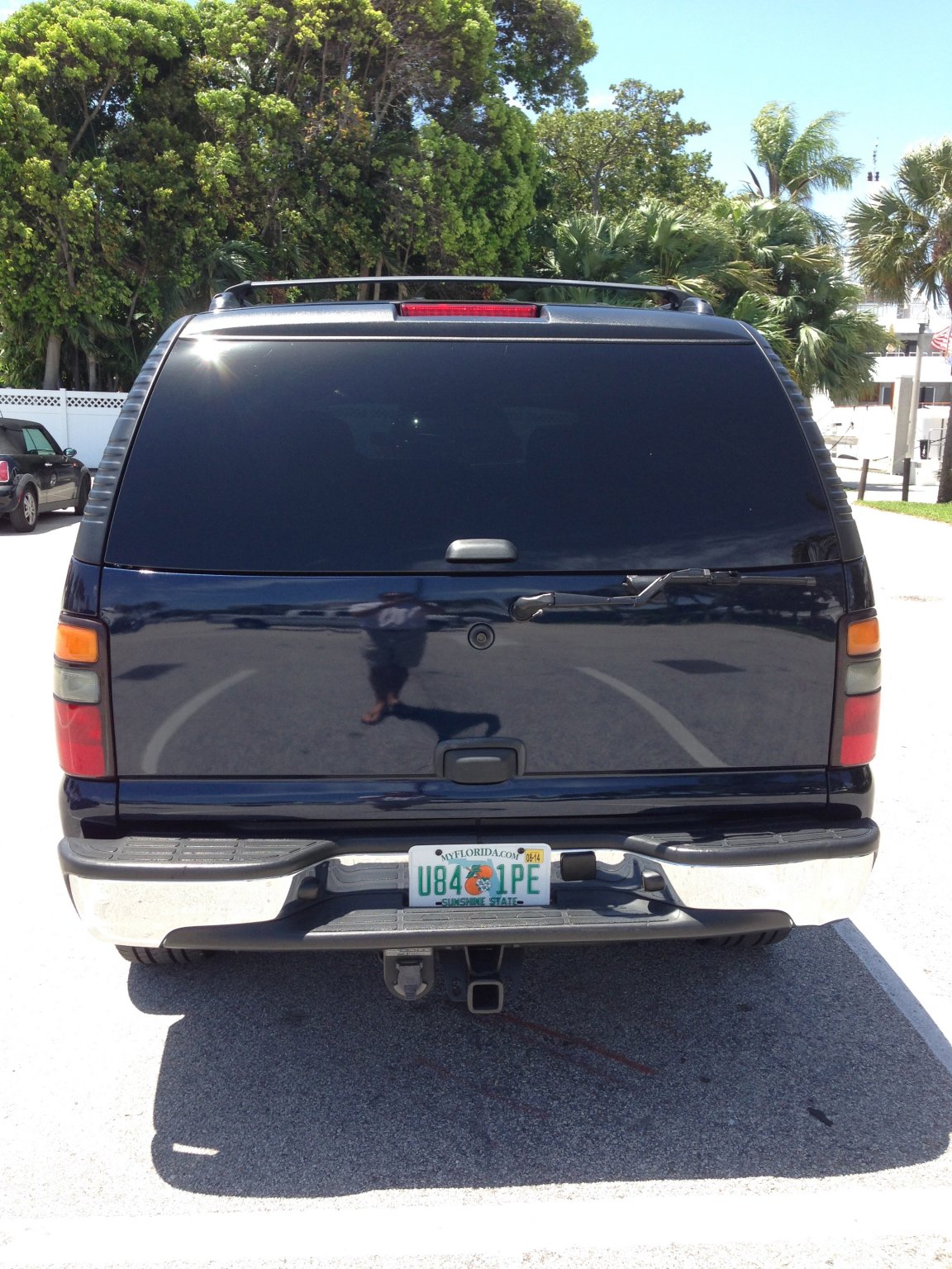

Your gonna hate me for saying this but you need to shave the rear completely.

No seriously did I miss the antenna mod? wanna do that this weekend
I unscrewed the antenna, pulled the cable back into the engine bay, tie wrapped the antenna under the lip of the passenger front fender, plugged the antenna back in, then used black electrical tape from underneath the hole to seal it up.
Reception is decent, but I rarely listen to FM so it is a non-issue for me.
Quick, easy, free and reversible. 30 minutes messing around getting it buttoned up perfect.
Antenna deleted.

Ok ive seen a few different ways. Jus didnt see you post how you did it. Did you get the caddy antenna cover then?
