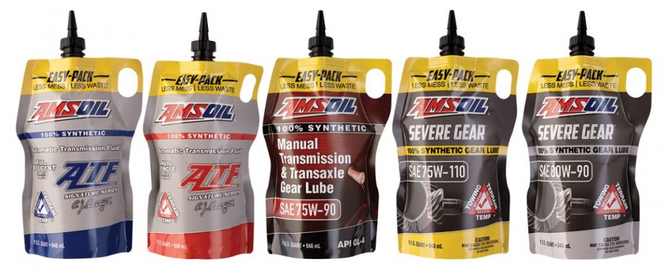

I’ll be changing the fluids in the transmission, font/rear differential, transaxle/transfer case… and wondering which fluids the cool people are using?
I’m thinking of using Amsoil:
Front diff: Amsoil 80w-90 Severe Gear (2qts)
Rear diff: Amsoil Sever Gear 75w-110 (3qts)
Transaxle: Amsoil 75w-90 Manual Trans & Transaxle (3qts)
Transmission: Amsoil ATF Fuel Efficient - blue logo - (6qts)
Anyone else running something different?

From my personal view: It's not so important which brand you use, it's more important that you look that the oil has the correct specification and that you change it regulary....
It's better to you to use a cheap transmission oil and change it ons the year, than to use a very expensive one and exchange it only every 100,000 Miles.

Probably not a "cool" person but, yes, we run something different: the fluids that GM specs. For example, your two-speed AUTO transfer case takes 2 quarts of Auto-Trak II (blue) fluid. The rear diff spec weight should be 75W-90 synthetic, etc.

I run similar in mine
Amsoil 75w140 in the diffs, with a slight overfill to make up for slower drainback on the thicker fluid (~10mm over stock. That nets out to the top of the fill port on the front, and bottom of the fill port on the rear. No dipstick method). Can argue semantics on it, but at the end of the day, my buddies have commented that I have the least shavings they've ever seen on a diff service. Actually discovered that one when I was trying to stretch my front diff for some extra life after the PO ran it try. Found that combo gave me lowest noise + lowest readings on a temp gun (this was very unscientific with a lot of uncontrolled variables please don't take this as gospel)
Amsoil ATF in the transmission - but I run the red stuff, not the blue fuel-saver.
For the transfer case - I have the push-button-auto-4wd thing. That one gets OEM GM 'blue' fluid. I've read the clutches are picky and never really dug into anything about it. Alternative fluids wouldn't solve any of the known issues with the thing like with some of the transmission wear items, so, I never explored it.

Transaxle? In a K chassis? Whatchu talkin about willis?
I run The GM Blue Fluid in my Tcase (Auto 4wd), GM spec in everything else but not neccessarily GM brand.
