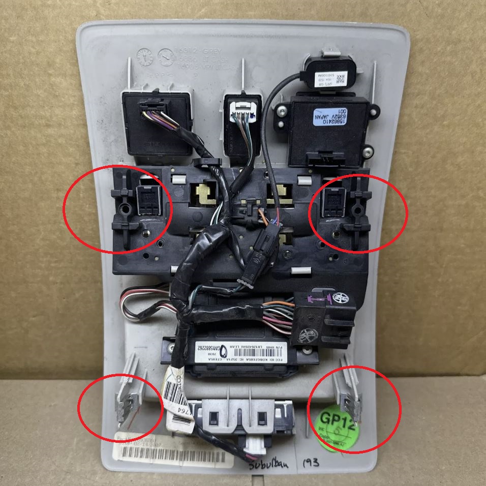

Got the dash pad off and both the grounds test good. It's definitely the dome light causing the issue. I can recreate the high resistance on the grounds just by reaching in the window and turning a dome light on. Anyone have advice on how to pull the front light assembly down from the headliner? It's not cooperating and I'm trying not to break it.

should be 2 screws and 2 clips
and if I remember correctly you pull it from the front at the windshield once the two screws are out, the screws should be accessible once the dome light covers are removed, those just pop off with care.
just be cautious I did break one myself and I was kinda mad about it
I replaced mine a few years ago because almost all the bulbs were burned out and broke one in the process, nice used ones usually run about $50-60 on ebay
the good thing about it is all the pieces are easily swapped out once you have it off

Thank you. I got it off without breaking it! And I'm testing voltage on the ground at the connector for the dome lights! About 3/4 of a volt. According to all data the ground for the lights is G200 which I believe is the passenger side under the dash panel. I'm getting zero volts on the body grounds under the dash. So somewhere up in the headliner the wire must be coming in contact with the body? I guess I should pull the center lights to try and isolate.

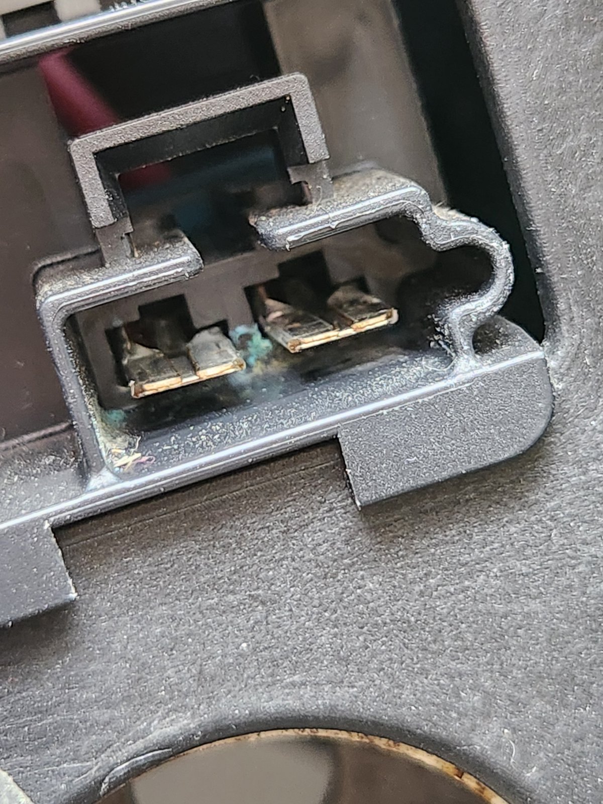

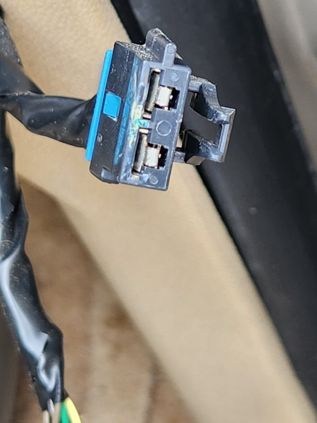

If anyone feels different please correct. It wasn't until I started taking comparative readings on my Suburban that I realized what I thought what I was seeing on the meter as defective outputs were actually normal conditions and then noticed the flickering was gone after cleaning the junction box. I'm thinking the only real way to track down corrosion issues is to actually physically track them down and see the corrosion. I guess that's why @Doubeleive is always telling everyone with electrical issues on 15 yr old trucks to "replace the battery cables"!

where exactly? right hand side edge dash behind the cover? or is this somewhere under/behind the glove box
Yes behind the cover. It's the junction box that sends the ground over to the LH side junction box under the dash and then up throughout the interior of the truck.

Open the passenger door and on the side of the dash there is a pull panel just like the one over the fuse box on the drivers side. Behind that panel is a junction box for all sorts of things. I found corrosion on the bottom connector which is battery and ground.

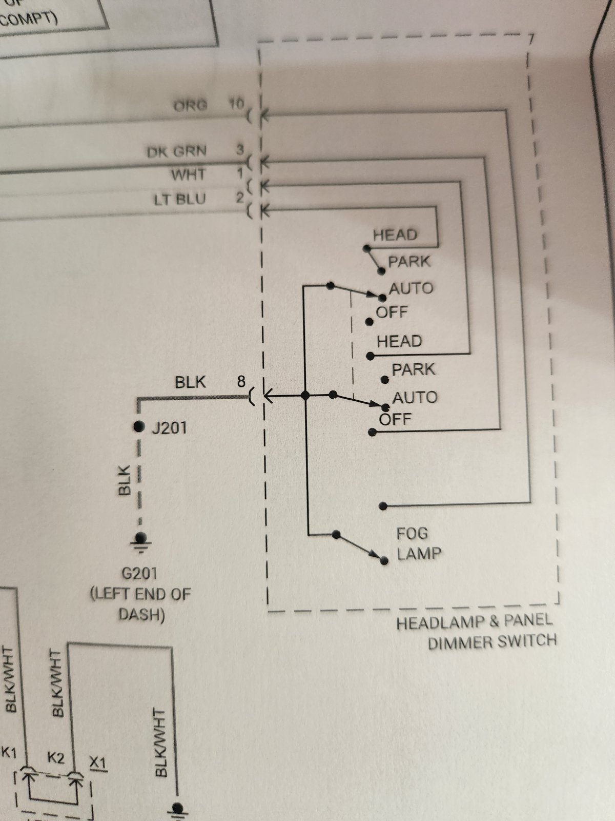

Thanks. That is much clearer. I pulled the potato chip dash cover that meets the windshield yesterday to test the ground stuff on the passenger side. Alldata says it's G200 and controls HVAC and dome lighting (which flickers for me)
I have tested resistance from the negative battery cable at the post on the battery to ground on the front of the cylinder head on the passenger side and the firewall where the ground strap is and am getting .2 ohm readings which I understand are within spec. Same at g200
I did notice that if I open a door, the truck 'wakes' and when I read resistance at those same points, it spike to 10 ohms. I'm not sure what this means exactly but after a few mins of closing doors, the truck 'sleeps' and the resistance goes back to .2 again.
