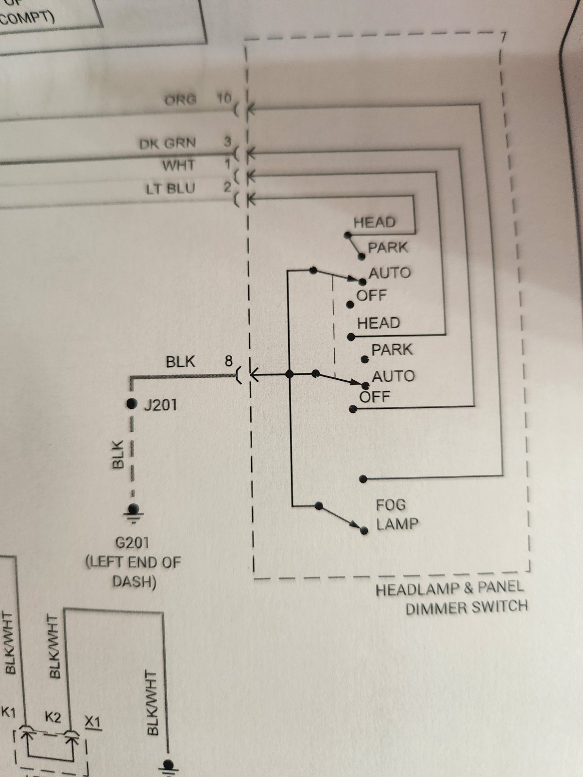

I'm gonna try and pull the headlight switch today and test this G201 ground.
Please do report back on this. Also would like to know about your ground testing procedure. I've read that the stud for this ground is known to be an issue on gmt900 trucks. Something about insulation getting caught in it during assembly and or that it becomes loose. The bad part about it is that to get to it you have to remove the dash which isn't fun. You see it or access it by removing the driver's side a pillar trim piece. I've tried.

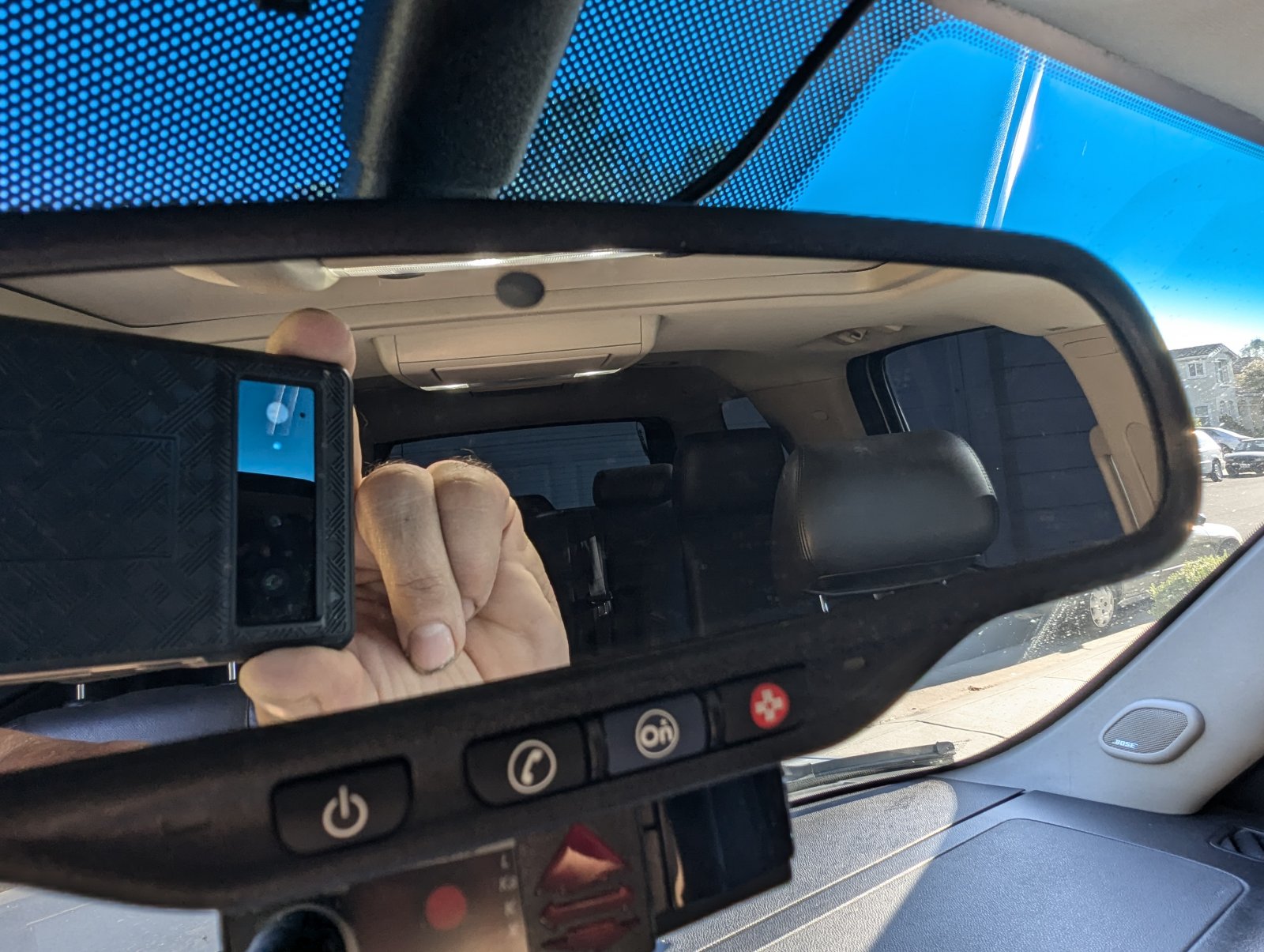

this sensor in the top center of the rearview is the mirror autodim, the egg shape one

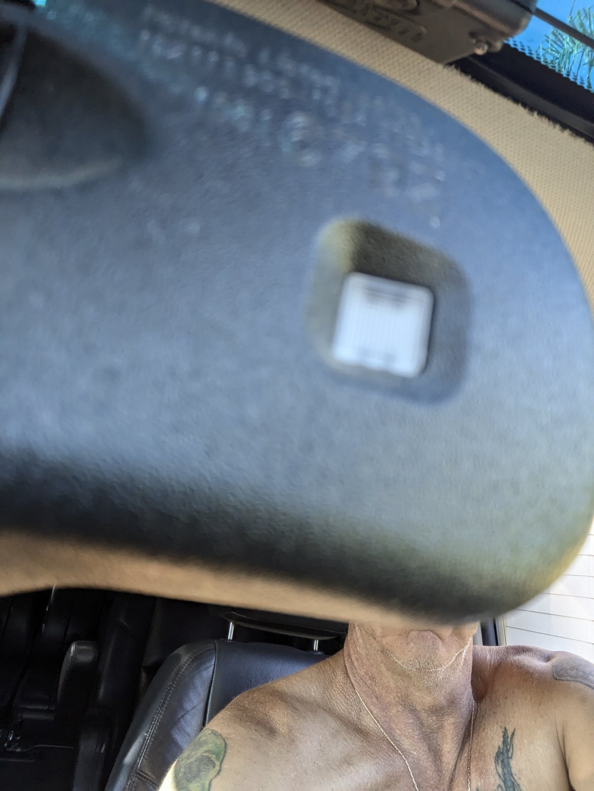

this square sensor on the front of the mirror is the interior light dimming sensor, if you have it covered or blocked with say a dashcam it makes the interior lighting/cluster go dim earlier than it should

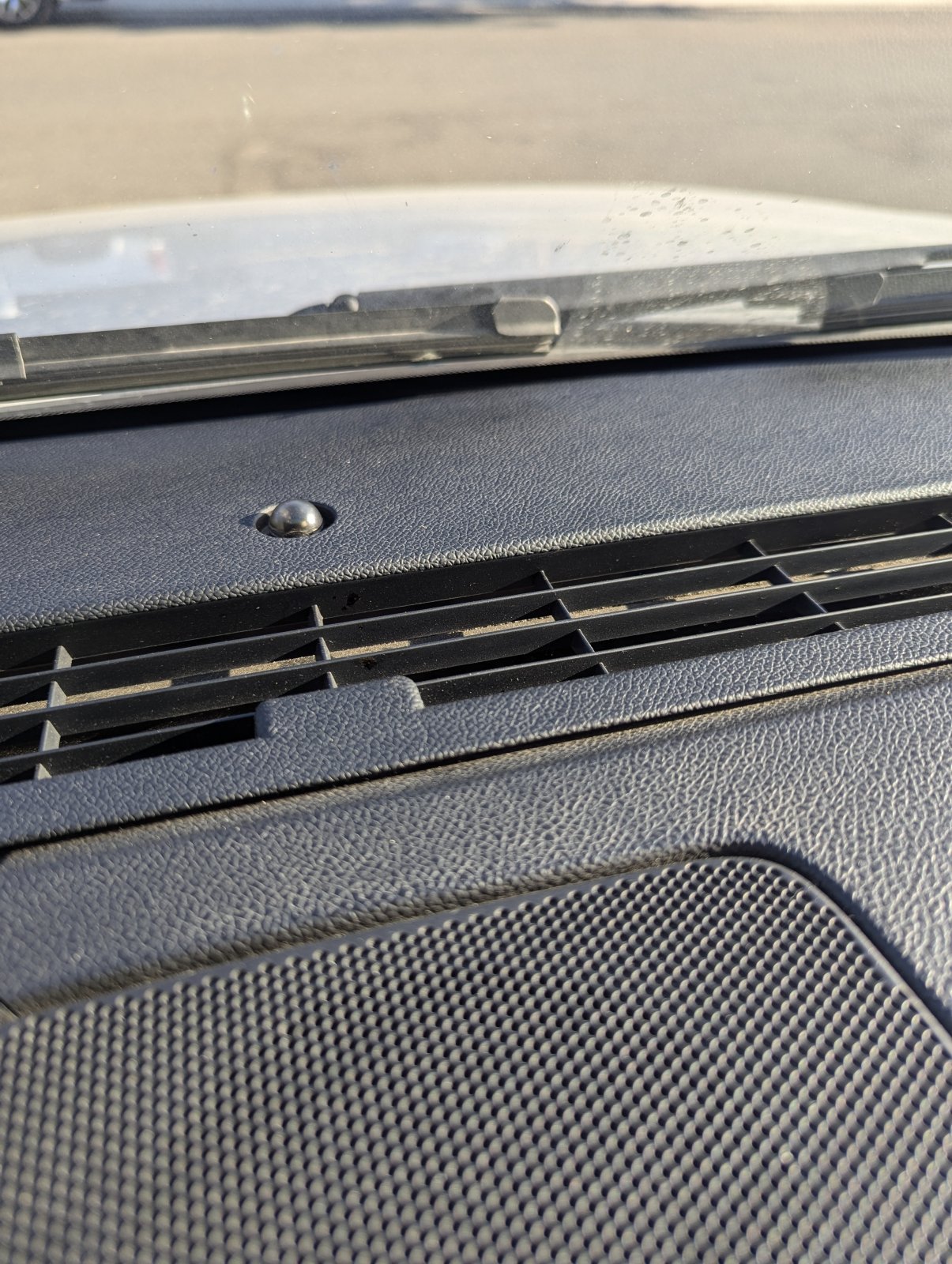

and this is the "sunsensor" on the dash front center (bubble shape) it controls how the hvac operates and also kicks on the headlights/drl's when it senses dusk/dawn, it also over-rides the interior dimming sensor (i think)
View attachment 436410 this square sensor on the front of the mirror is the interior light dimming sensor, if you have it covered or blocked with say a dashcam it makes the interior lighting/cluster go dim earlier than it should

Right now I'm just going to test the ground from the headlight switch connector and see what I get. The procedure I'm using is with a multi meter putting on probe on the negative battery terminal and the other probe on the ground I want to test. With the meter on ohms the resistance should be pretty close to zero. Also need to check for voltage which should be pretty close to zero also. I'm probably going to need a jumper wire to reach from the battery to some of these other grounds not in the engine compartment.

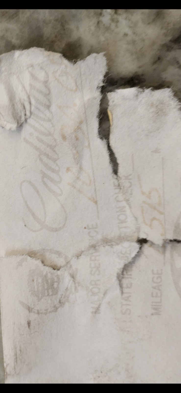

Little update not related to the flickering lights. I'm standing in front of my house looking at the Yukon thinking about what @Doubeleive said about the sensors on the mirror so I walked over to check them out. Low and behold there's a sticker placed over the square front facing sensor. I peeled it off carefully and it looks like it's a oil change reminder sticker from a Cadillac dealership dated 10/30/2008! Lol. Is it possible at this trucks first oil change somebody covered I guess a semi important sensor? Not sure what kind of change I'm going to see but the lighting and mirrors have definitely been acting wierd on this truck.
View attachment 436427View attachment 436428
ya anything in front of it or even near covering it will make the inside lights dim, not sure if it would cause flickering, maybe if it was seeing conflicting sunsensor readings
