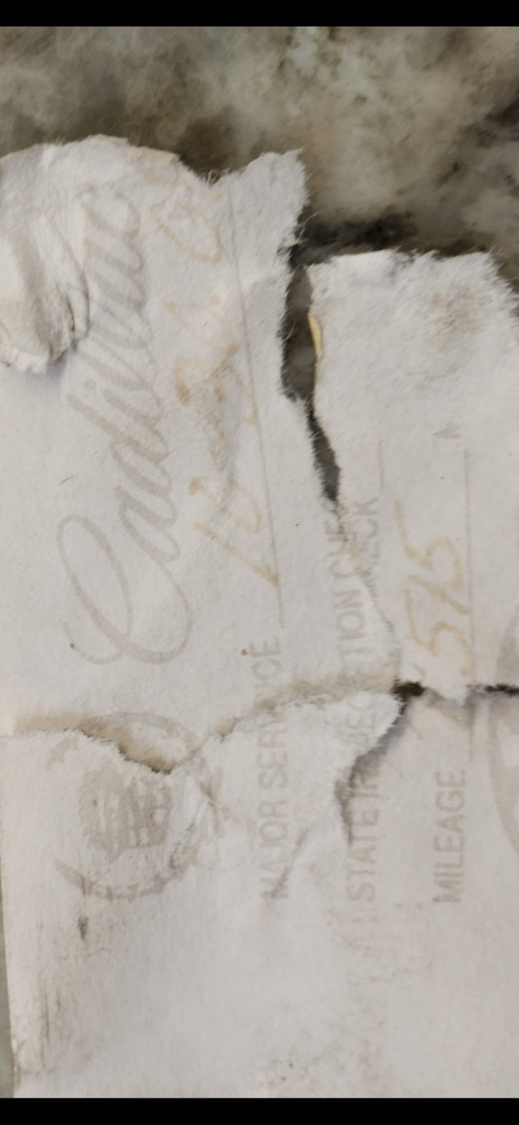

Little update not related to the flickering lights. I'm standing in front of my house looking at the Yukon thinking about what @Doubeleive said about the sensors on the mirror so I walked over to check them out. Low and behold there's a sticker placed over the square front facing sensor. I peeled it off carefully and it looks like it's a oil change reminder sticker from a Cadillac dealership dated 10/30/2008! Lol. Is it possible at this trucks first oil change somebody covered I guess a semi important sensor? Not sure what kind of change I'm going to see but the lighting and mirrors have definitely been acting wierd on this truck.

ya anything in front of it or even near covering it will make the inside lights dim, not sure if it would cause flickering, maybe if it was seeing conflicting sunsensor readings
