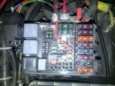

finding a power source to tie into
I added a relay and double tap fuse wire into the fuse panel for an ignition on/ hot wire for my e-fans. You have to check with a meter in the fuse box but one side will be hot (on all the time) and other will switch on when you turn on your ignition. Also had to notch the cover a little to not pinch it.
