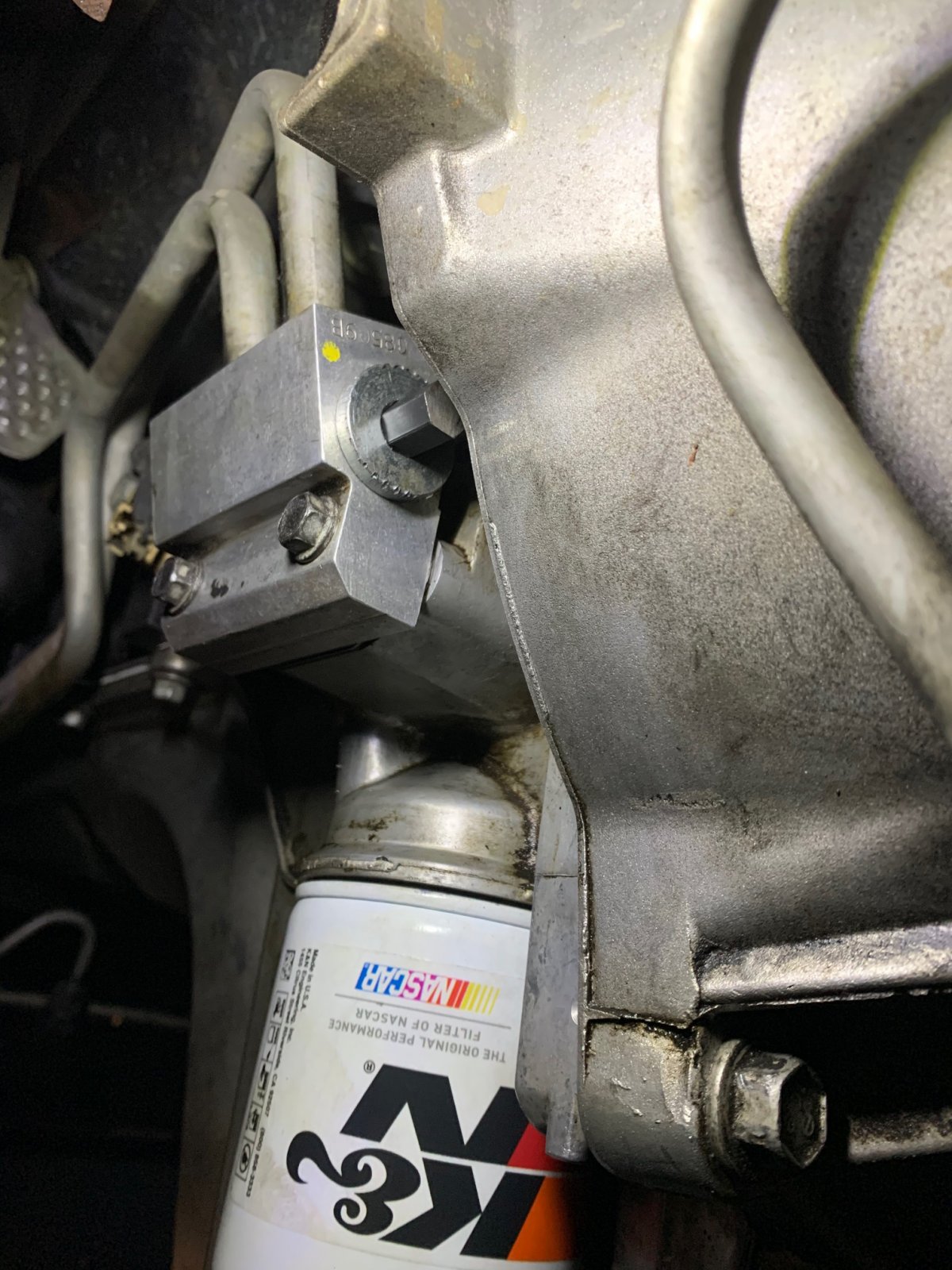

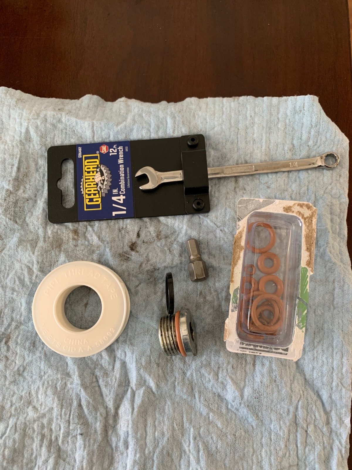

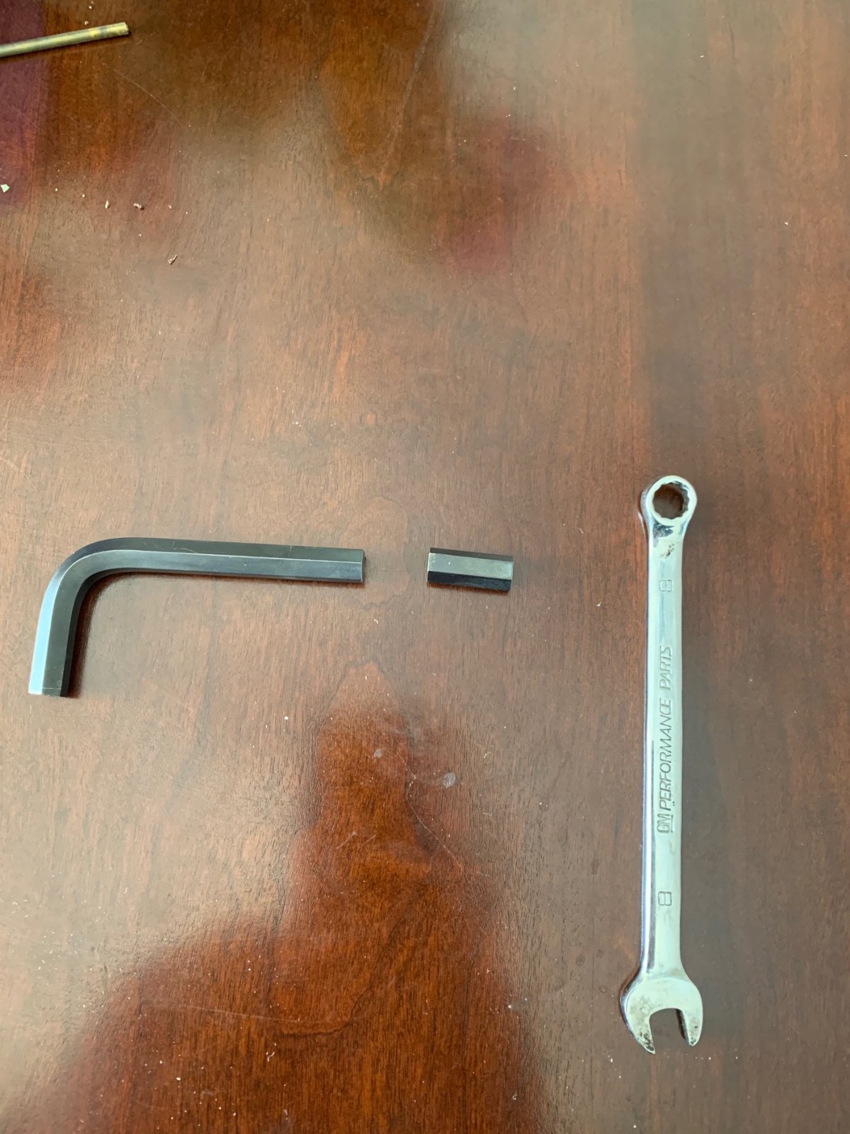

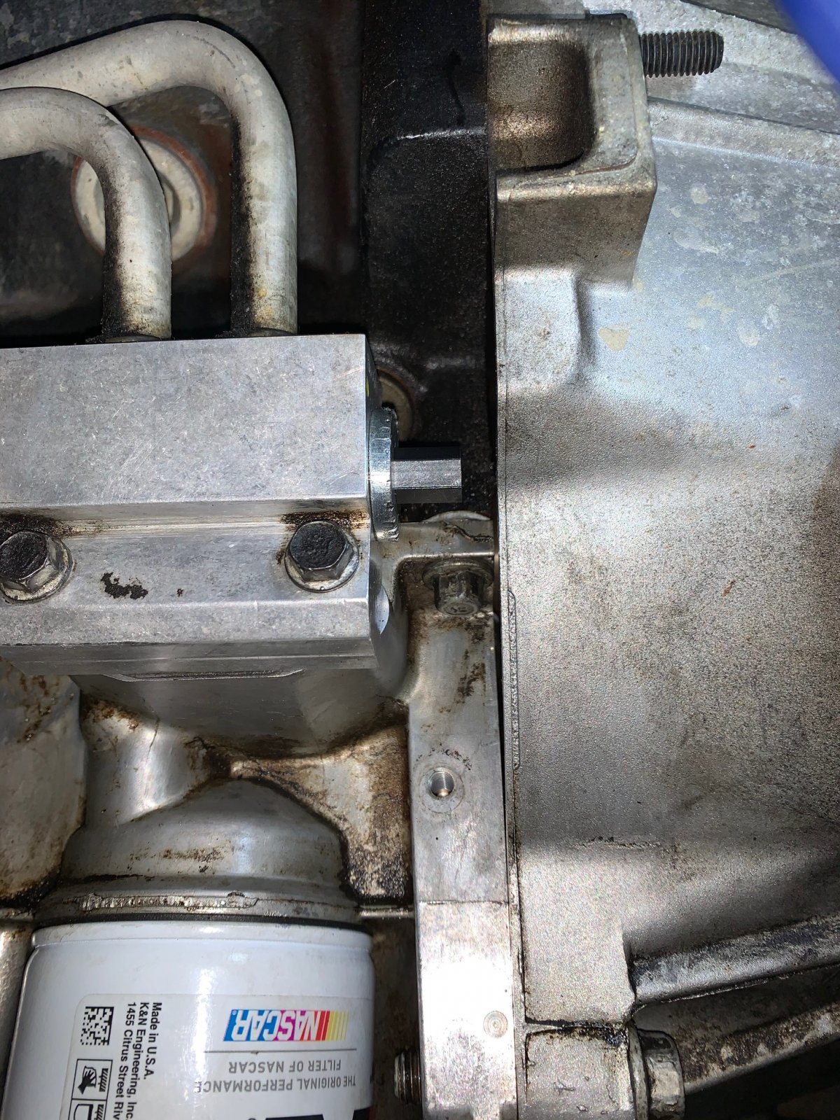

I has had some oil consumption issues that i've done the DOD disable w/ newly designed valve cover install. Lately its been plagued with oil leaks, so i pulled the pan and did the gasket, and while I was in there I did the O-ring for the pick up tube and the AFM shield for the oil pan. I probably dont need it since i tuned out the DOD, but it was only an $8 part and I was already in there. Anyhoo the oil pan gasket did slow down the leak a little, but didnt completely fix it. I purchased some UV dye to put in the oil and found that it was leaking from the plug on the side of the oil cooler block. Please see attached pics. I modified a 3/8ths hex to fit in the small face and pulled the plug to find a hard piece of plastic acting as the O-ring. I went and purchased a small o-ring kit and a 9/16th o-ring fit. I also applied some thread tape as well, before re-installing it. The pic has a 8mm wrench, its actually supposed to be 3/8th. Slip the short hex into the plug then the wrench over the hex and torque down the plug. I wanted to share this since I didnt find much on this and figured it would be able to help someone.

In this case, the o-ring sits completely inside the female thread receptacle--unlike, for example, a common oil drain plug where the edge of your crush washer is visible underneath the head of the drain plug, even after tightening. This design allows this plug to seat all the way into the threads, and bottom out, rather than stopping short a couple of millimeters as it would with a washer under the bolt head.
Because of that unique design of the o-ring, and because mine still seemed to be in good repair, I decided to clean up the area and reinstall the same plug and original o-ring...but this time, added a bead of red high temp Loctite around the circumference of the o-ring for some extra insurance. Tightened things back up guttentite (can barely get my hands up there, let alone my torque wrench).

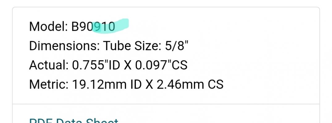

JUst went through this on my 6.2 and this was the best explanation so far, so i thought i'd add what i noticed.

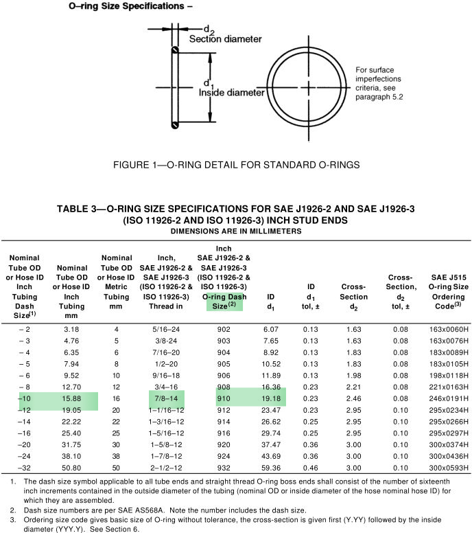

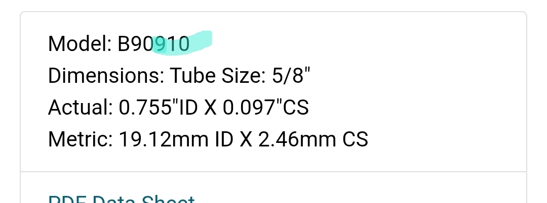

This plug is a #10 ORB or MS Boss O ring port/plug. You can get these steel plugs with o rings for $2 some places. Also, this was intended to o ring seal, so the added teflon can potentially obstruct the seal. The listed o ring size is a 910, but as mentioned Viton would be ideal for temps if you can find them.
Thanks for the above info to get me on track.
