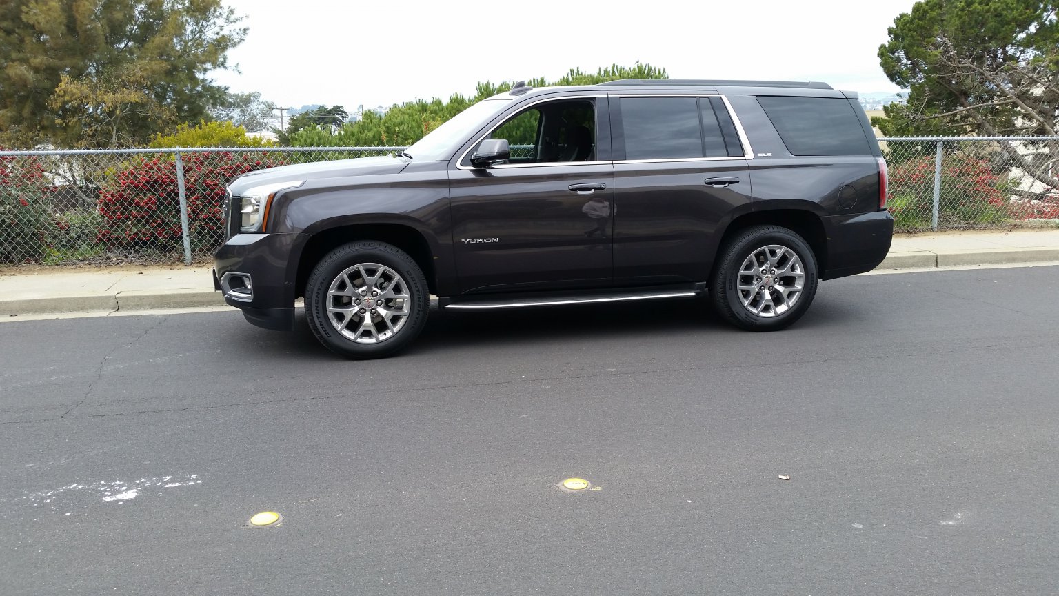

Thanks, very detailed presentation. Do you have any "after" pictures of a 1.5" rear drop ?
NORCAL SS
SUV SUSPENSION GURU
Jun 9, 2009
8,744
610
Yes this was 2.25. Im going to lower front 1 inch next

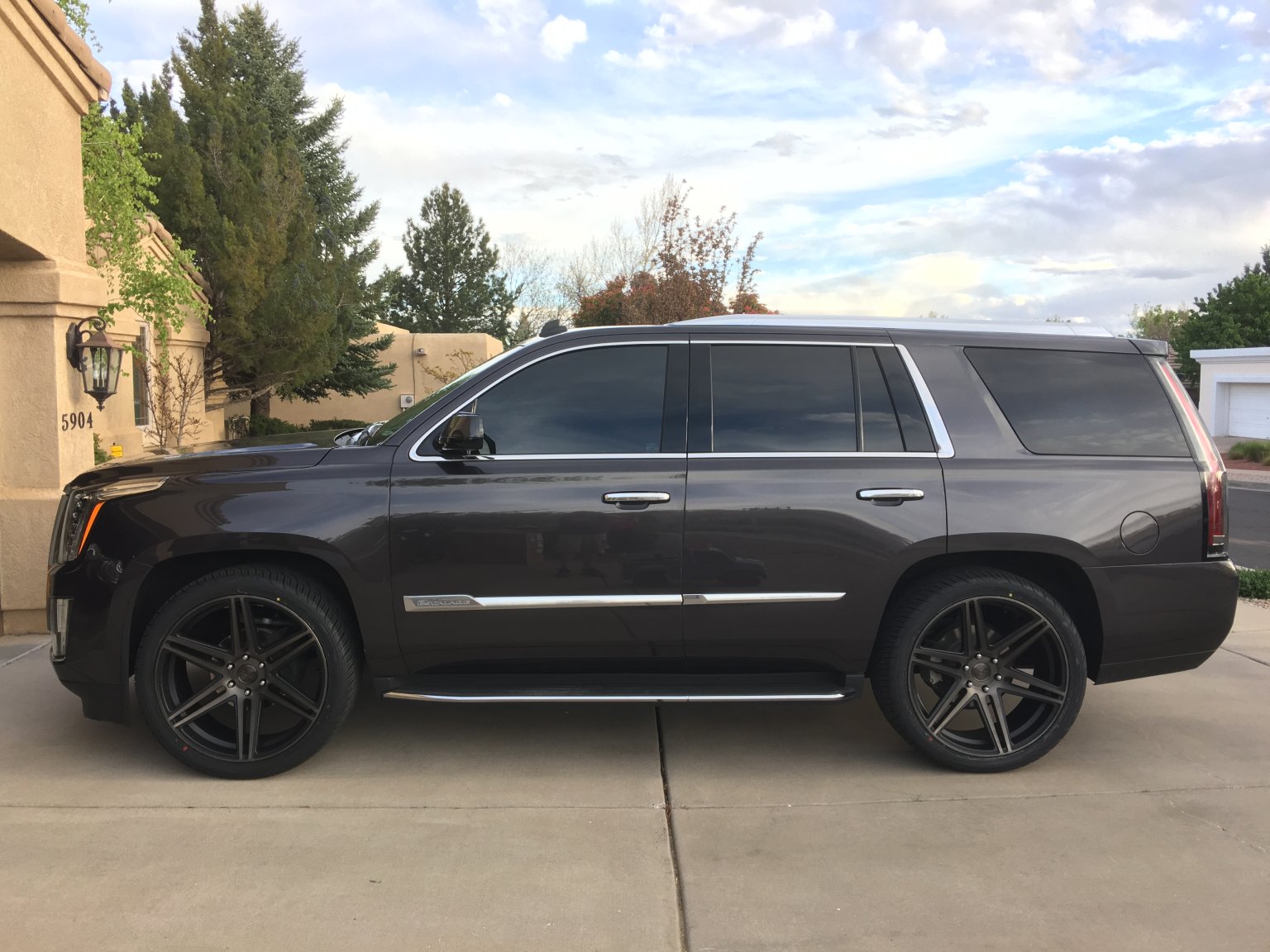

I've got Tony's rear kit on my Escalade. I dropped the rear 2.5" so it would sit just 1/2" higher in the rear for a VERY slight rake. I think it's perfect but here's a pic so you can decide for yourself.

ratt. that stance is great. what size tire / wheel combo ?

Just installed the same kit on our 16' and 1/2 rake but barely detectable until you measure it. Props to Tony
