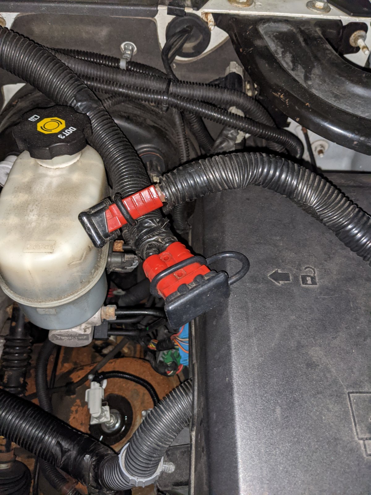

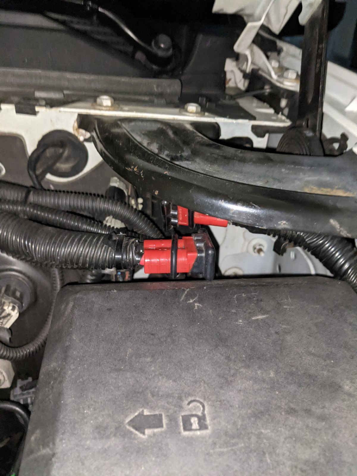

I have dual batteries, but there are not connected at all times. I have a high amp quick-disconnect connector on the second battery leads that I connect to the charging system once a month for about 50 miles of driving to keep that battery's charge topped off, and then I disconnect. My hope is that if I have a primary battery failure in the future when I am away from home, I can simply reconnect the connector on the second battery and keep me going.
Regarding starters, my starter on my 6.2 failed at 130k miles.
You mind posting a pick or how to of your setup?

The ground for the second battery is connected to the same stud on the engine block that the main battery's ground is connected to, and the 12v hot wire for the second battery is connected to the same stud on the main fuse block on the fire wall that the primary battery's 12v hot wire is connected to.
Brandon2489
Jul 28, 2018
138
101
View attachment 351464View attachment 351465
I appreciate that. Thank you!
