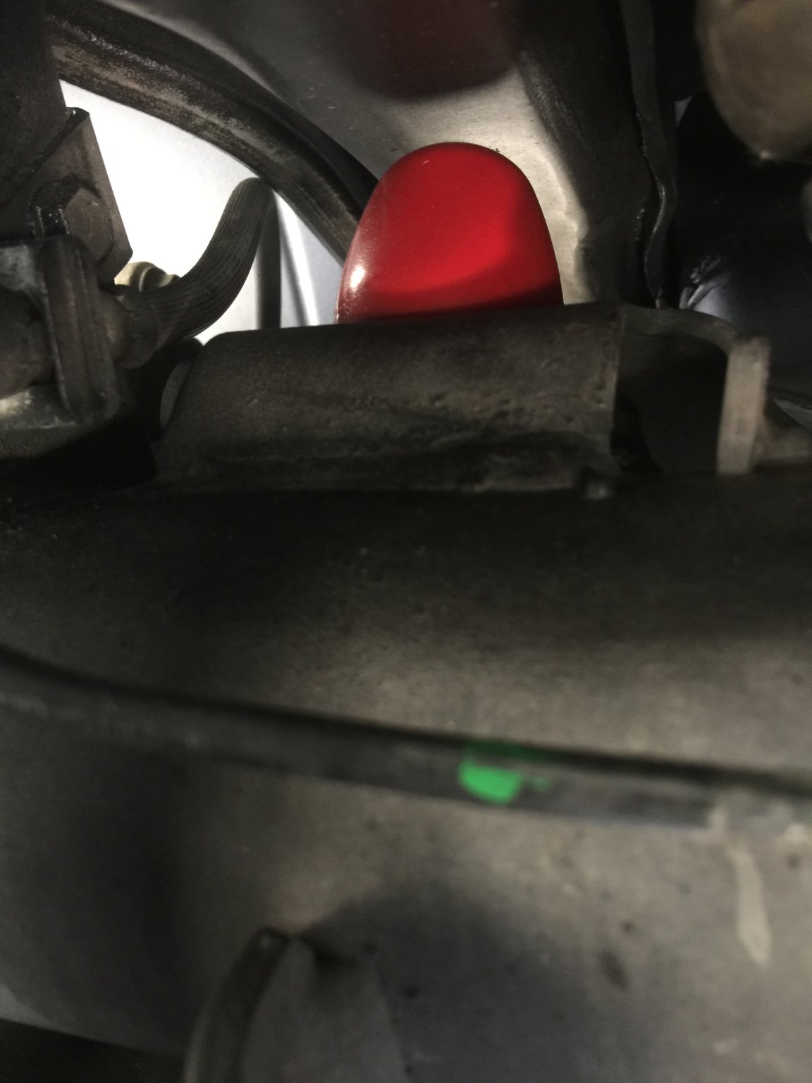

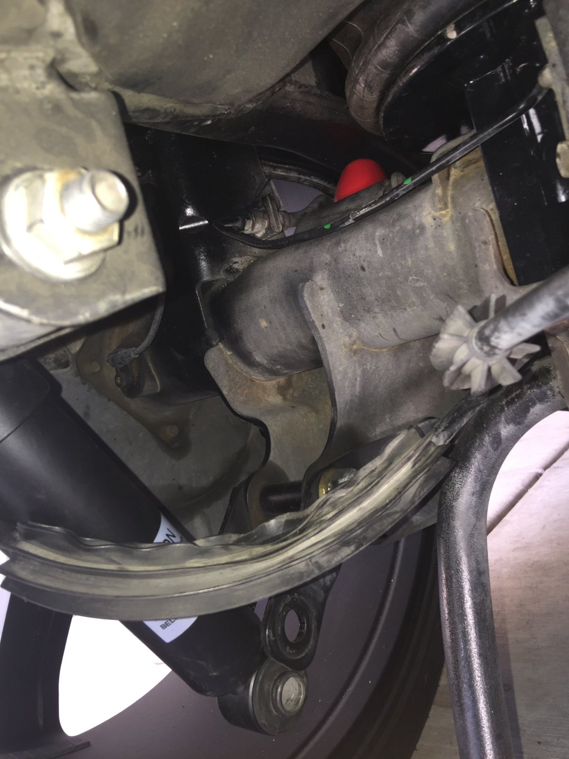

Do yourself a favor remove the red bumpstop and see if the truck goes down. If the panhard bar is not hitting the swaybar and if the shock isnt bottomed out then your pretty much at the lowest point and the bag is bottomed out. There has been 2 cases where a taller bag was used on the kit the customers had to get them swapped out. this was years ago.
Theres is literally half an inch between the red bump stop and the frame with the sway bar disconnected and the shock length fully aired out is only 16 inches so they have another 4 inches left before bottomed out. So guess the bag is bottomed out.

do yourself a favor. get some tbss bags from dealer. They will ride a lot better too.
also just to be sure have you disconnected the shock and see if it went down more... or verified that it is 12.xx inches collapsed by pushing them in and measureing

Shocks and sway bar disconnected and aired out not touching ur bump.

yup its the bag. Junk it and get the tbss bags. GET OEM GM since aftermarket rub frame

the top locks it in. Theres nothing to mount on the rear axle. so you know the upper/lower mount is the same as the trailblazer ss so like from the factory the trailblazer ss bags just get locked in up top and bottom rests against the mount. Ive been doing this bag swap for years and the bag set up you got customers swapped out and wish they never installed it. Like i said ride better/sits lower and tows a BUNCH more
