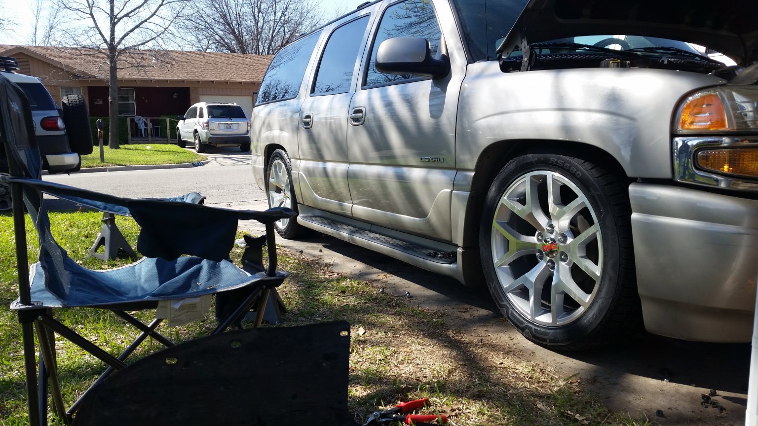

Hey what's up everybody? I figured I should start a thread on what I'm doing with my yukon.... So I was at 3/5 for 2 years with norcalss kit and was debating on leaving it there and doing 24's but I wanted more low. I thought I had a great deal on these same wheels in 24s but that fell though so I decided 22s and lower! I bought belltech 2in drop spindles a few weeks ago and finally had some time to get everything put together.
Specs
04 yukon denali xl awd
22" gm honeycomb reps with 285/45 22

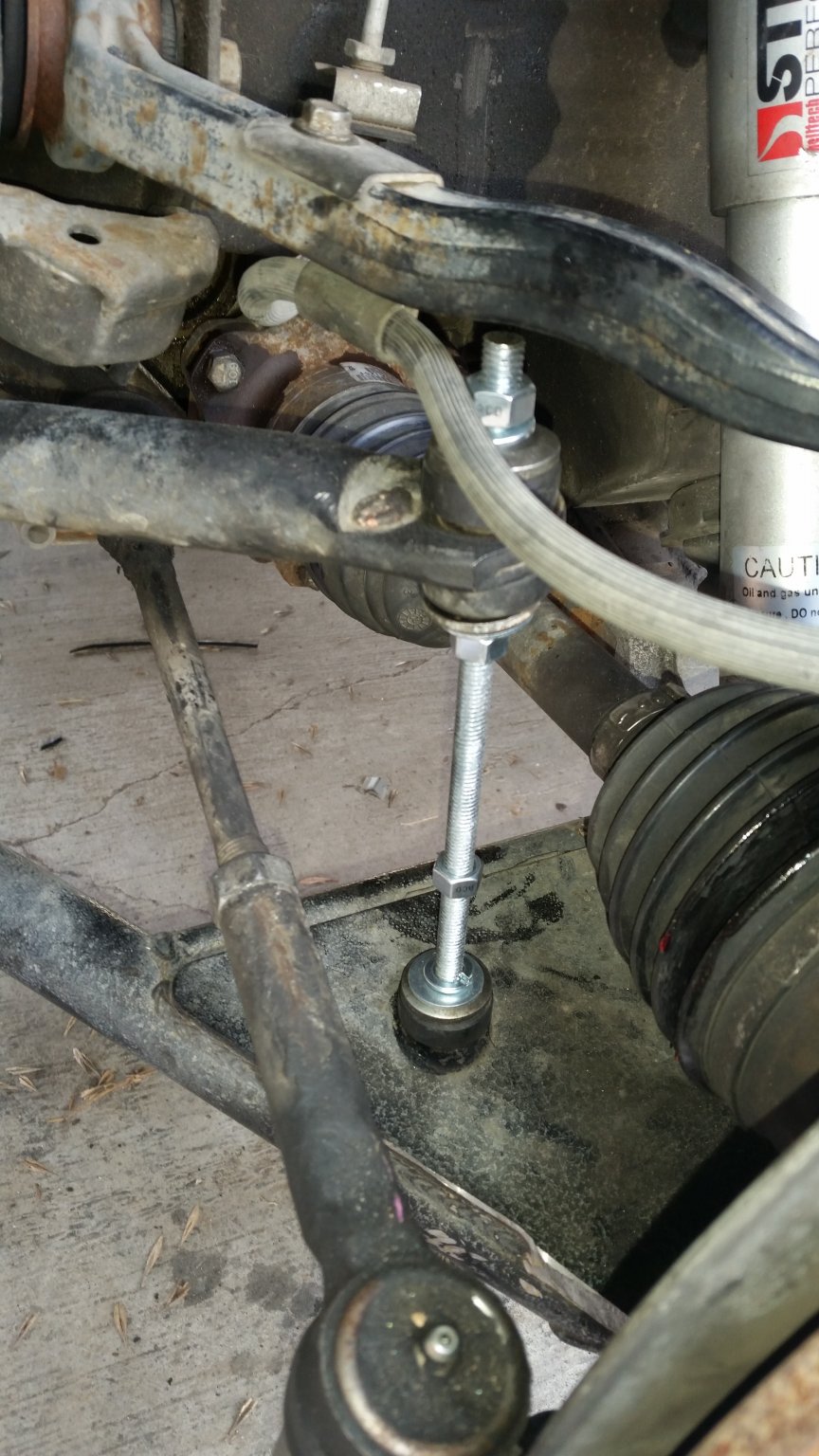

I think it was a djm sway bar bracket but the bolts broke so I'm going to try all tread

YES, YES, YES! Looks killer.
Man, I'm rubbing at full lock with a 3/5 on 285/45/22s. I was going to go 275/40/22 but got a deal I couldn't pass on these tires.
26,372
51,829
That looks awesome but no way is that 5/7. Did you take before/after measurements? I have a 2/3 on mine with 26's and yes you will have to do some work in the front in order to turn good, and you'll still get rubbing in certain situations. The inner fender wells are just the start! Some metal work will be necessary as well as rolling the front fenders or you'll pull the inner fender lips down if you hit a bump just right, probably going in or out of a parking lot/ driveway at an angle or dip. I did it and got lucky it was easily fixed. Good job though!

In the process of adjusting the 3/8s all thread for my sway bar.

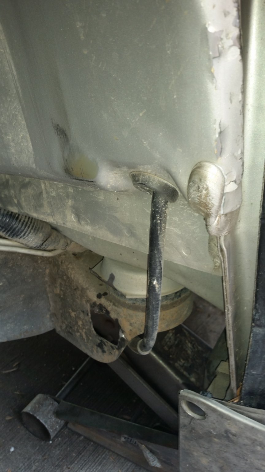

The emergency brake line went through this body mount so I just pulled it apart and went around it. There are to places that stick out that had to be trimmed, 1 on the Frame above that hole and 1 on the top body mount. I still need to pretty it up and paint. When I figure out the gap issue I will tear everything apart and paint and powder coat everything.
