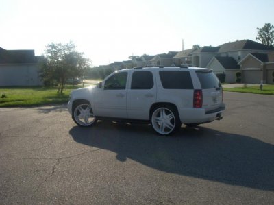

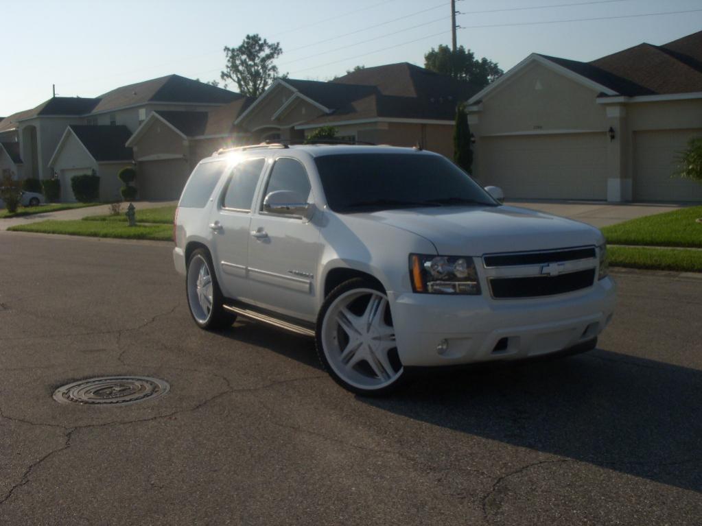

Bought Tony's Belltech 2/4 drop with the adjustable front struts. Gotta tell you, this thing rides BETTER than stock. I had the 26's before the drop. No ride change in the front but soooo smooth and damps really nice in the back...Lil background, this is a XFE hoe. Measure 1" lower (all 4 corners) than regular tahoes. I measured 36.5 in the front and 38" in the back (floor to fend lip) before the drop. so I lowered it 1.5" in the front and 3" in the back (spacers on). With 26" wheels it measures 35" front and 35.5" back. Lil plastic trimming was req... Yes, yes, yes I had an aligment done the same day. Next, blackout tail lights and posibly debadged....
