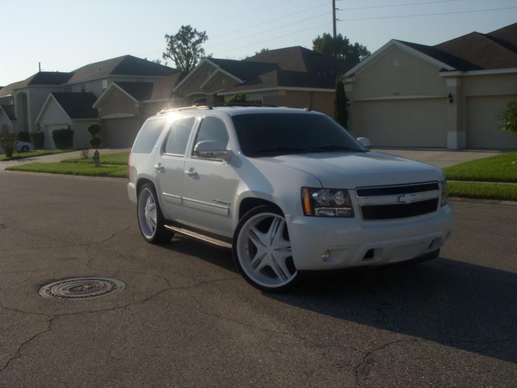

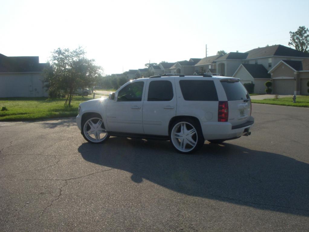

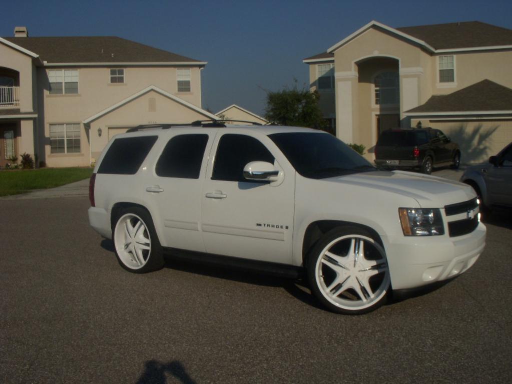

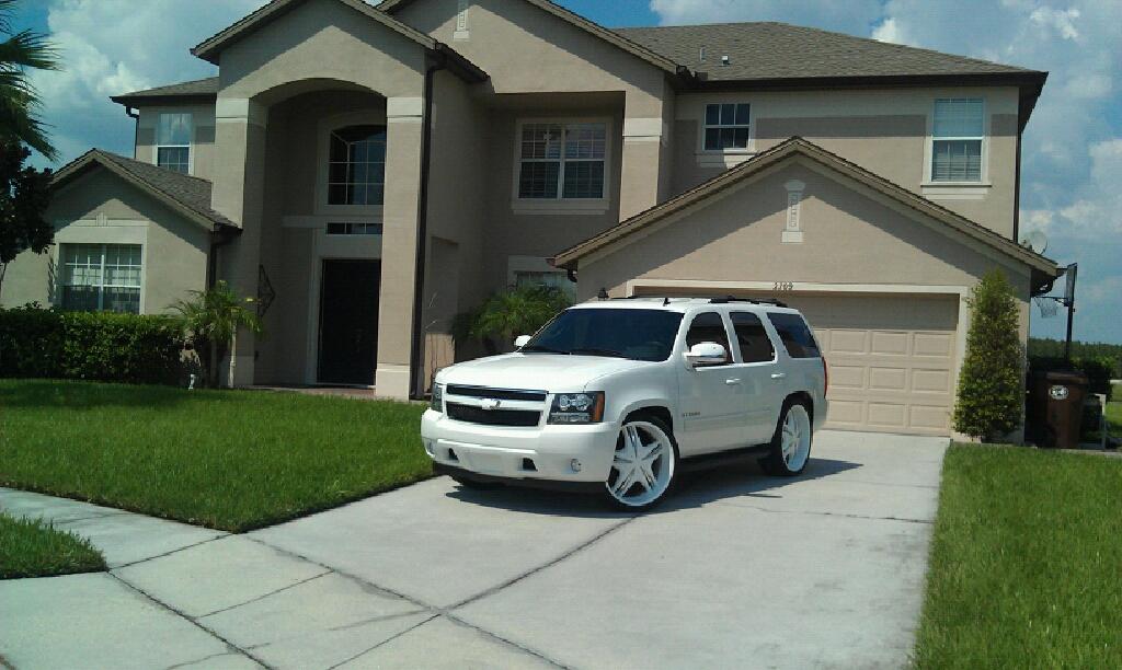

Bought Tony's Belltech 2/4 drop with the adjustable front struts. Gotta tell you, this thing rides BETTER than stock. I had the 26's before the drop. No ride change in the front but soooo smooth and damps really nice in the back...Lil background, this is a XFE hoe. Measure 1" lower (all 4 corners) than regular tahoes. I measured 36.5 in the front and 38" in the back (floor to fend lip) before the drop. so I lowered it 1.5" in the front and 3" in the back (spacers on). With 26" wheels it measures 35" front and 35.5" back. Lil plastic trimming was req... Yes, yes, yes I had an aligment done the same day. Next, blackout tail lights and posibly debadged....

50% on windshield. 15% on front Windows. 30% over stock back windows and 5% rear window. Belltech adjustable struts (-2/+2 part 25003) 3-4 coil spring (part 5305/ 1" spacer 35323) bump stops (4925) and shock extensions with hardware (part 6651) . The kit also comes with threaded links for auto ride hoes (part 3901). The whole kit was $450.00 with Tony....FedEx 6days coast to coast....

Sorry for the lat late response.. I'm on 305/30/26. As far as trimming goes, I drove it for a lil while then pulled the wheels off and trimmed everywhere there were signs of rubbing. There were non on the top part of the liners but I used a heat gun on both front wheel liners (front part close to the fender and back part close to the doors). I also had to push the winshield fluid reservoir forward and kind of hold it back with a metal string to the fender mounts and also hammer the lilttle metal part of the chasis that sits right infront of the front doors before the tire biggins (it's underneath the liners). Use a rubber hammer for that!! The back was a cake. No rubbing in the top but had to cut a bit the inner sides of the liners (both sides)....
