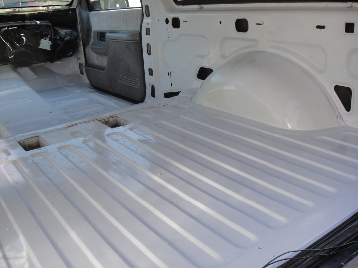

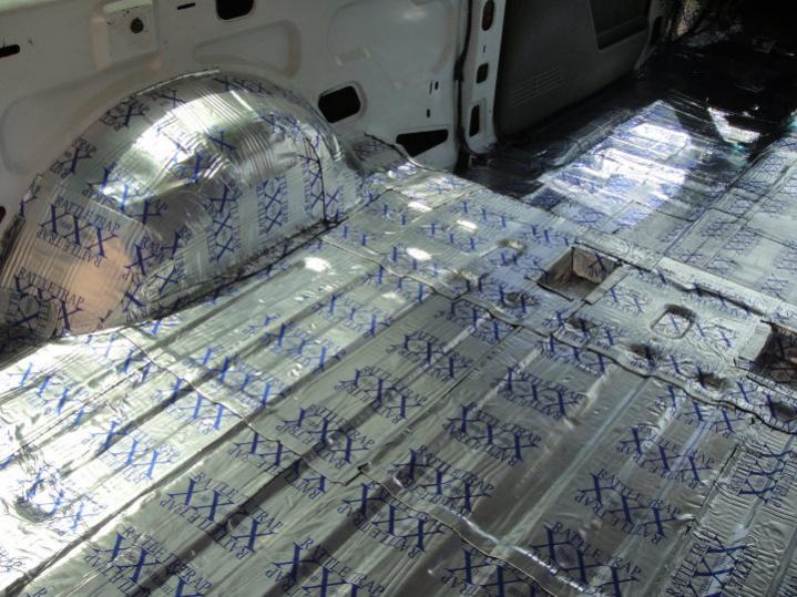

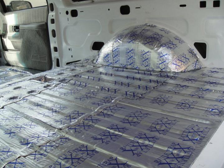

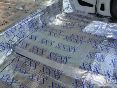

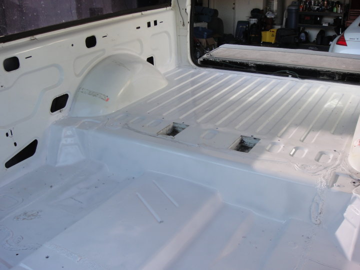

Here are some pics of my install with the Fat Mat Rattle Trap product.

And one more. I did the entire floorpan, and rear ceiling with the 100ft roll, and had some leftovers to do some odds and ends. You can also see I removed the bracket on the driver side wheel well as I had no use for it.
