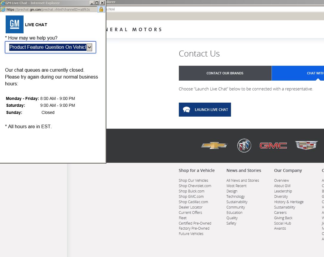

I GOT MINE IN ABOUT 5 MINUTES ON THE GM LIVE CHAT, you might get lucky maybe they bought 2 adapters and wired them together and didn't cut the factory harness, lol fat chance

What is this gm live chat?
https://www.gm.com/site-help/contact-us/chat-with-us.html
start chat, then select :question about vehicle I already own
they are available as shown in photo everyday except sunday

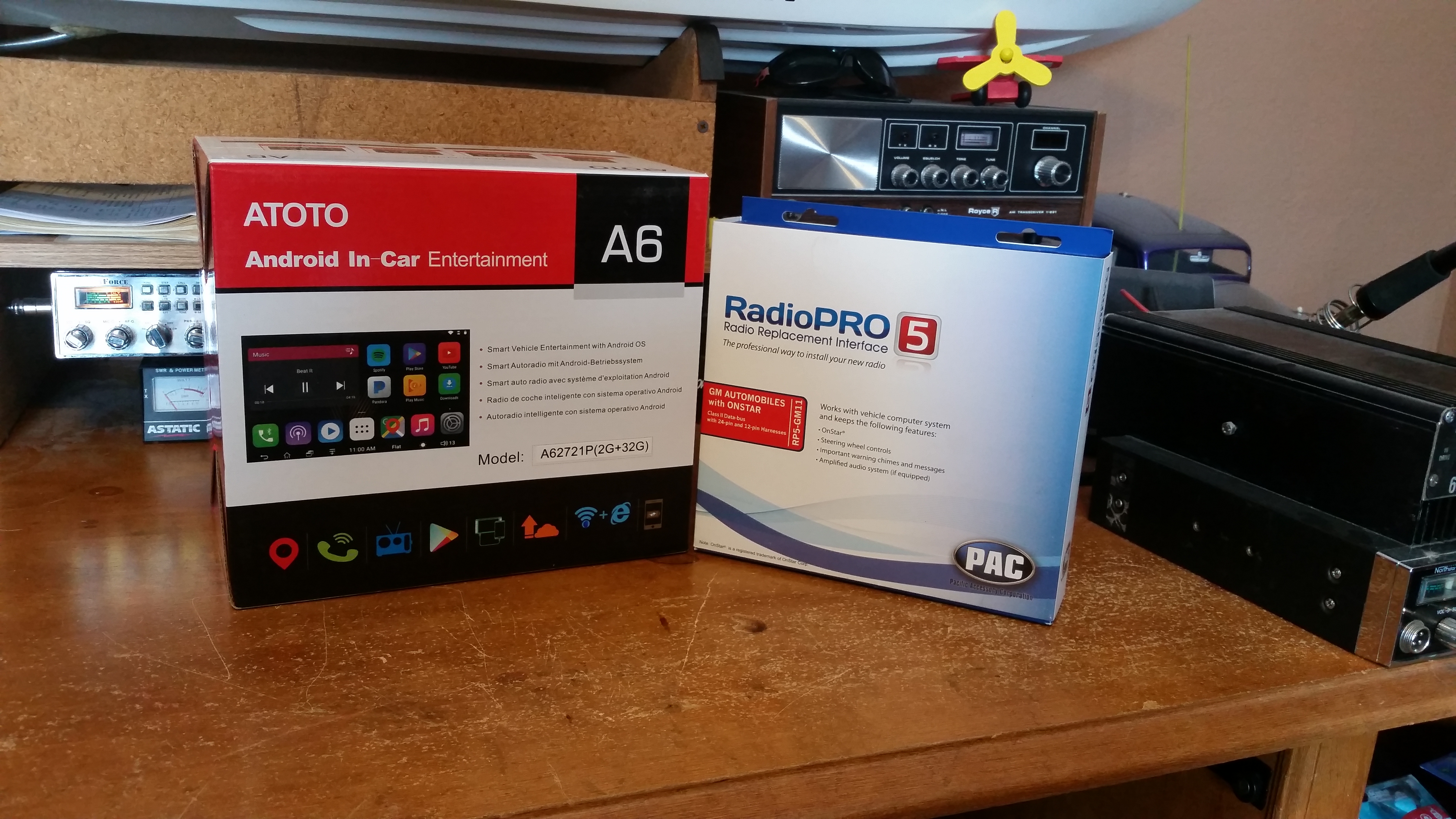

Well, this showed up today. I havent opened it yet. I still need to grab a few things, like an install kit and some wire connectors.
I will have more pics/videos soon. I will make a new topic about everything when I do. Im stoked to get this hooked up though. First order of business, root this thing, hopefully.

Well, I have had this Atoto A6 head unit in my truck for a little over month now and while there are two or three things that bug me from time to time, they arent deal breakers by any means for the price I paid for everything and I really like it and am more than happy with it. I have still yet to do a post and/or video on my thoughts on it but I will soon, I promise. Other than that, a few tweaks and it sounds great with the factory Bose system. Eventually I will get around top testing the output voltages of the RCA outputs to see if they are all over the place or not. I tested a Pumpkin head unit a while back that a friend had gotten for like $150 on ebay and the RCA output voltages were fluctuating like crazy making the amp and subs not sound all that great. Not horrible, but not great. Hopefully this doesnt have this issue.
