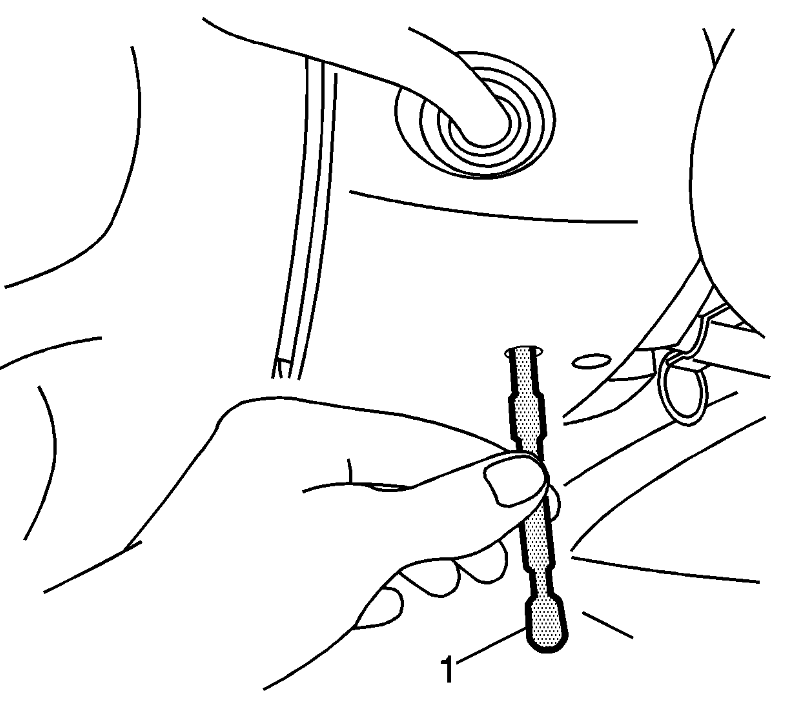

If you decide to replace the driver's side, you really have to remove the intermediate steering shaft. The steering wheel has to be locked into position so that the alignment/steering is not messed up when doing this. I bought the Bosch, OTC J-42640 steering wheel anti-rotating pin to lock it into place off ebay.
Where does this lock pin go?
Also, would the automatic wheel lock that activates when the key is off not do the same thing?
21,299
30,254
There is a hole in the bottom of the steering wheel for it. GM deleted this in many models of cars years ago. I know the Escalades have it but my SLT Yukon XL does not, neither do my Sierras.

that lock is interesting. not seen that.
