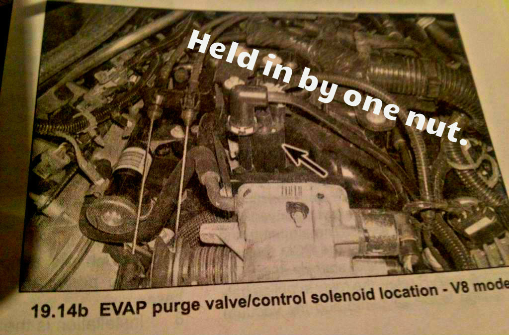

looks like the only part left to replace is the charcoal canister. Where is that located on these trucks?

I thought the system consisted of the solenoid, vent hose and canister. Is there more?
main components are canister with active charcoal filter which absorbs fuel vapours from tank, purge valve (controlled by PCM), vent valve (controlled by PCM).
You make have a leak in the system or the fuel tank pressure sensor is NFG.
Always check the hoses first, a damaged or missing hose is the most likely cause of a malfunctioning evap system and than the Charcoal canister is next. Also check all related fuses.
