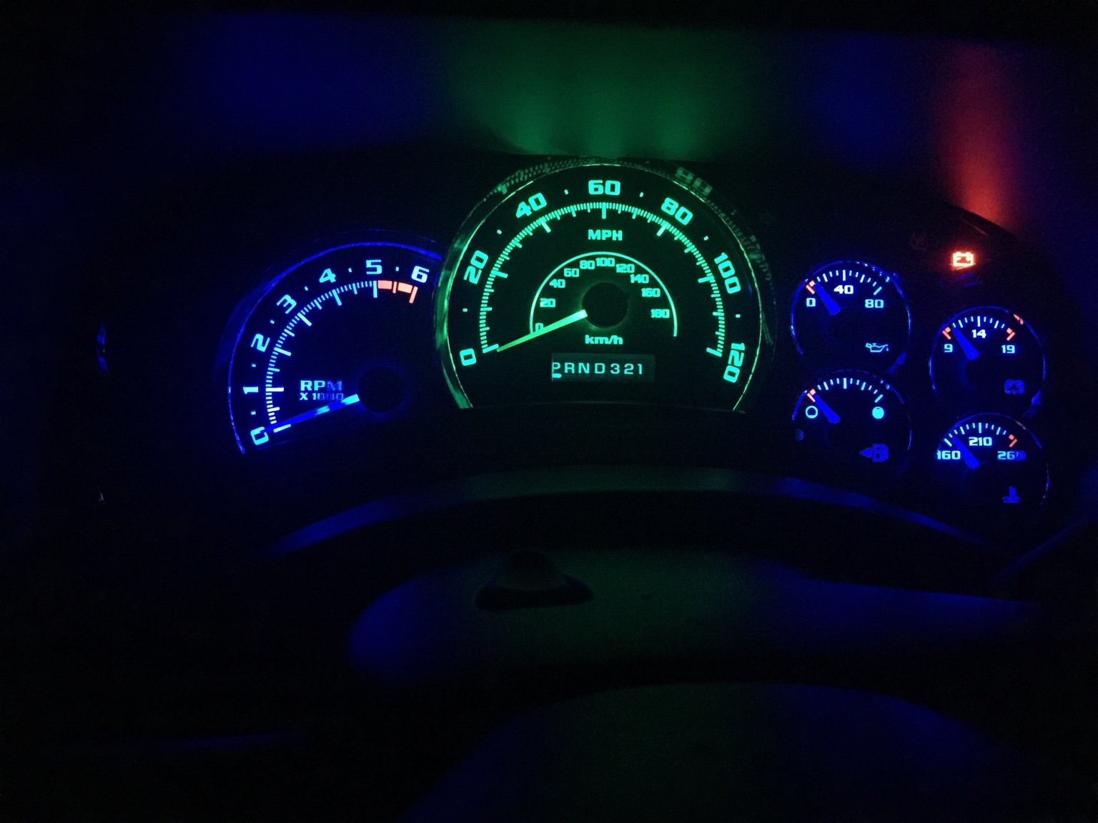

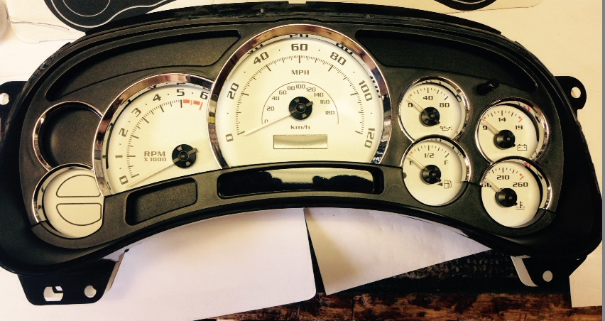

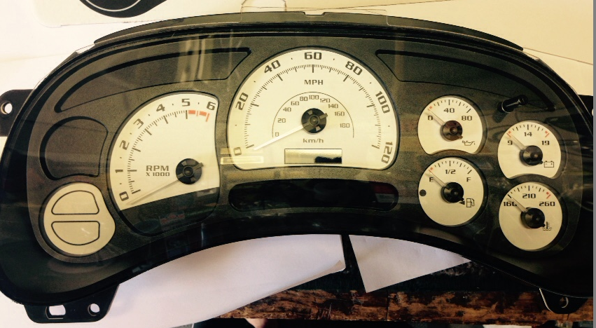

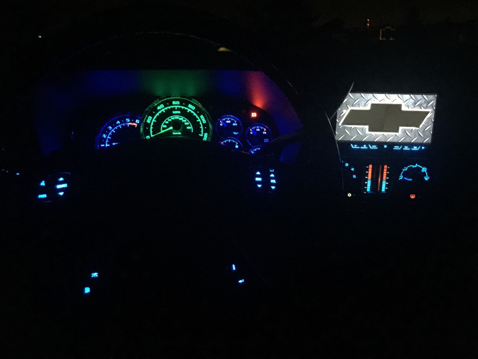

When I changed my gauges to white escalade style and did the Green LED backlight conversion I ordered US Speedo parts. Check out their website http://www.usspeedo.com/ they have a lot of different options for the look without having to purchase the entire cluster to achieve some of the looks everyone on here is talking about. (I would search around places like Summit, CarID, and Stylintrucks to see who has the best prices) The parts worked well and seem to be made well, however the customer service is pretty bad. I ordered Green and got blue LEDs for my HVAC controls. Kind of dumb if all other lights are ordered Green that I might want my AC backlit in blue lol. Once I got all the correct parts all worked well and install was pretty easy.
LED backlighting is not hard but it takes time as you have to solider the LEDS on the board. As far as the gauges go you literally just have to remove the cluster from the truck, take the needles off with a needle puller tool or a fork works too. You can then swap the gauge face out and put the new needles on. I took photos of my gauges before I pulled the needles and aligned based on the photos. They do self align a bit also when you put them back on. You can feel the stepper motors resistance.
White Gauge faces with Stock Tahoe rings
White Gauge faces with Chrome Esky rings
