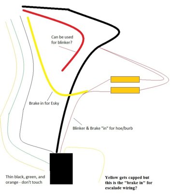

Just scored a pair on ebay for $750 shipped! GM OEMs, not reproductions. Lenses need a little polishing up cause they have some abrasions but no deep scratches or cracks. I can't complain. Time to oder up my resistors and I submitted a support tickets to AutoLoc and Signal Dynamics to see if they help me get a CANBUS compatible tail light splitter. I want to see if I can get the blinkers to work without dragging wires from the front blinkers of the truck to the rear. It will be a more costly setup but it will be self contained and a "cleaner" install. I'll keep you posted on my progress.

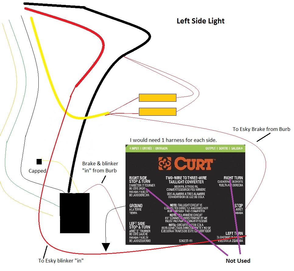

OK so I have my esky lights. Based on what your diagram shows you are stating what my rudimentary pics show. I'm just clarifying because I work with visuals better than text. And while your explanation is good, a picture to me is better.
With this diagram the lightsabers act as both the blinker and the brake light. Correct?
So my next question is, if I use a trailer harness to separate the brake and blinker flow, I would need to do that on the red wire inbound from the esky taillight harness since that is carrying the juice from the brake and blinker on the hoe/burb setup? (see next pic)
I just want to make sure I am doing this right. I may need to tie in additional resistors so I am not sure if I should tie them into the same thick black wire your original configuration is in or the thin black wire that isn't used in your original install. I am OK giving up the yellow LEDs for blinkers if this doesn't work out but I am leaning on the forums for a little guidance since I am no expert when it comes to auto electrical. Hoping for a response soon.
