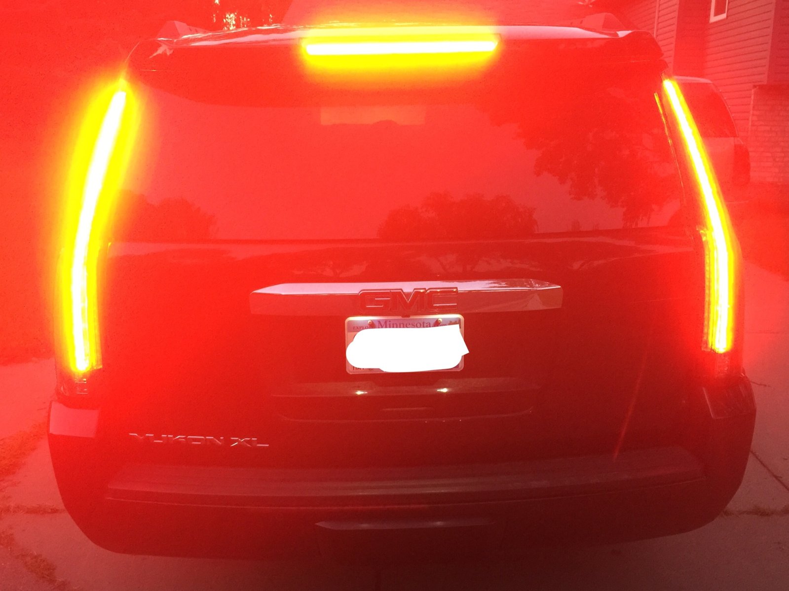

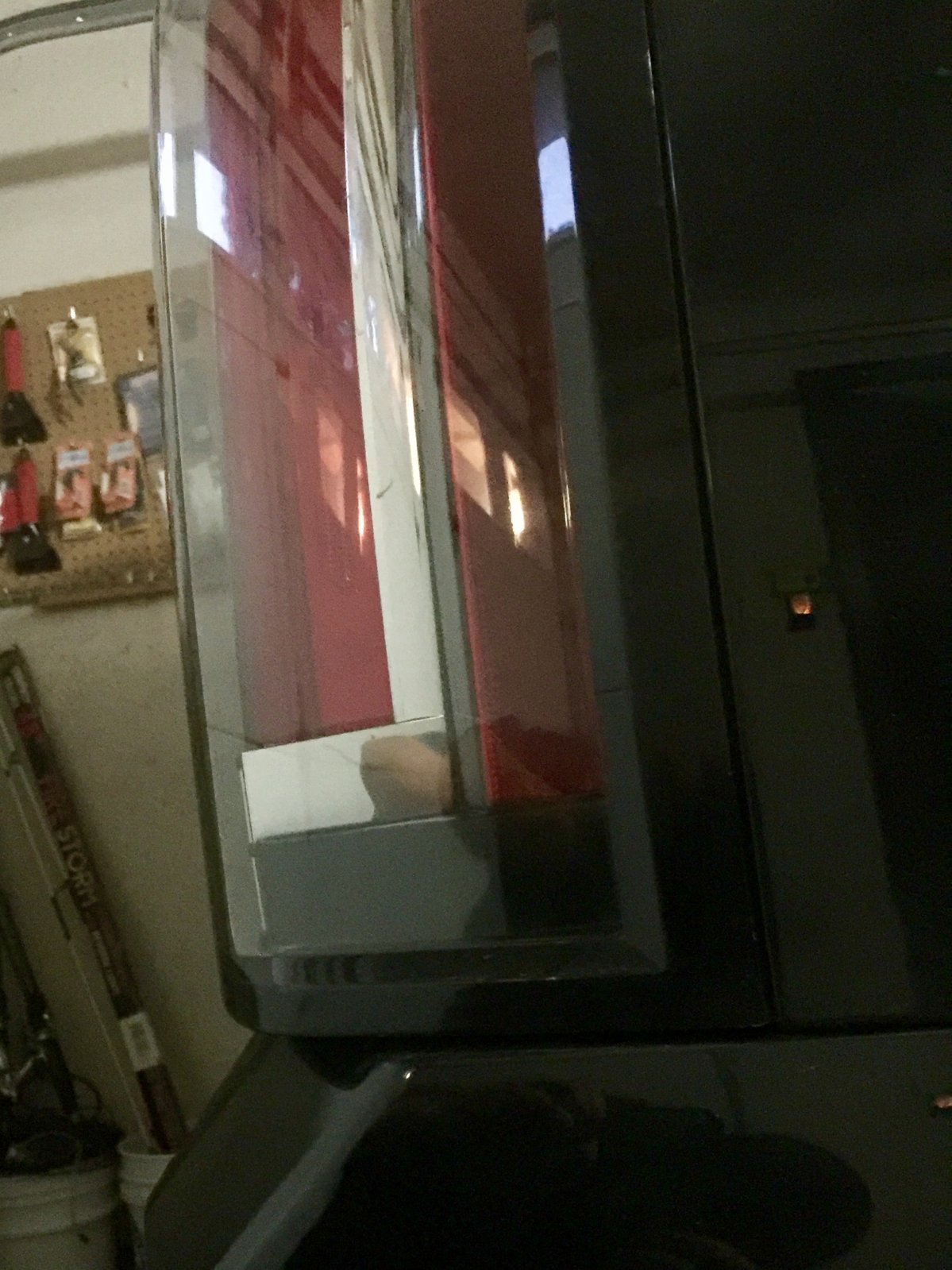

Installed used OEM tail lights on my 2015 Yukon SLE XL past weekend. Straight plug and play. Have people doing double takes. Only issue I have is that there are no reflectors in the tail light housings facing the rear of the vehicle. If your vehicle is parked in a dark area, cars approaching from the rear may not see your vehicle. I notice on the Escalades, the reflectors are in the bumper. Wonder if the Escalade bumper is a straight bolt on. Would take care of reflector issue and that slight overhang the tail lights have on the Yukon bumper.

I bought them off eBay. Different seller for each side. I think I paid $250 for one and $260 for the other. So basically for the price of the cheap knockoffs, I got genuine tail lights. Be patient and you will find **** Escalade owners selling because of very minor scratches. Mine have very, and I mean very minor scratches. Couldn't spot unless pointed out. I will post pics tomorrow when it's light out.

looks sweet
i may be able to live w/ overhang of lights , like that.
might hav to add these to my burb, after i lower it more.

They may not be plug and play for the suburban from what I've heard. May be possible with a lot of headache.

^ yeah , they wont be PnP.
turn signals wont work w/o extra wiring & such (or trailer adapter)
