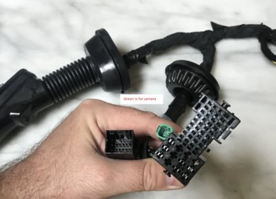

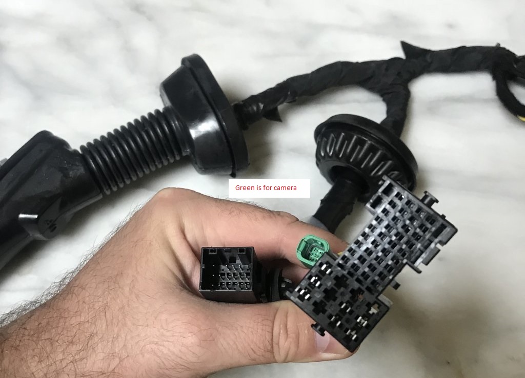

Green is the harness side plug for the camera

Here’s a pic of the harness from the Esky mirrors to the Esky door harness.
Here’s a pin-out of the camera jumper harness.

Those circuits land in the door to body harness connector at positions 4, 11, 12, 13 & 26.
