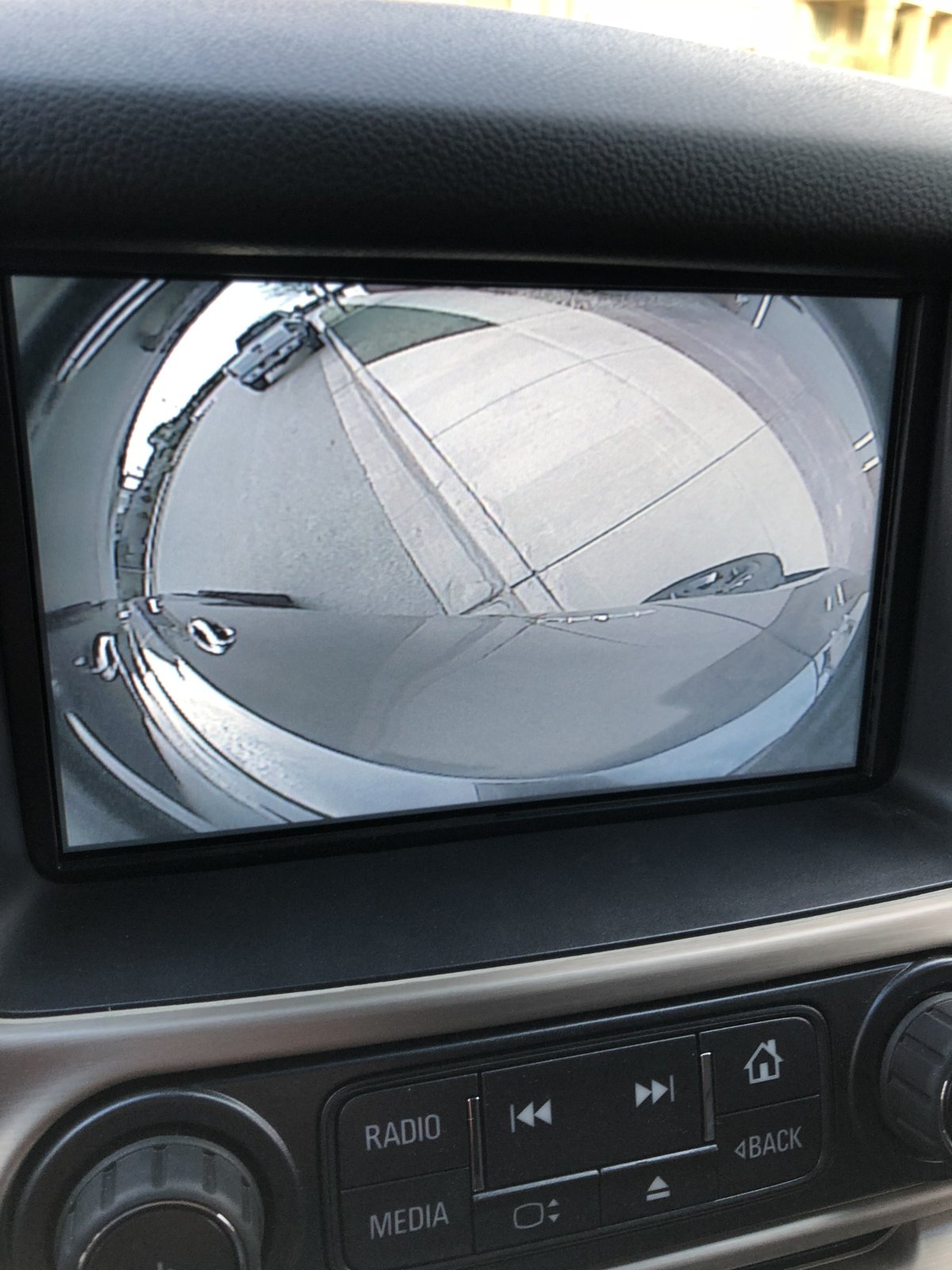

It worked. Just got it back from my audio video guy. Oem cameras will work!!

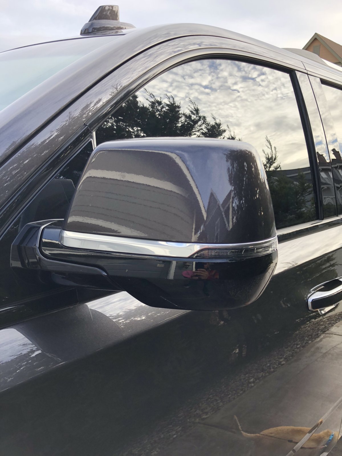

I bought two oem Escalade mirrors with the camera and all options. The full 360 surround system with the mirror iPhone option from MVI. You have to buy the kit with their cameras but we simply cut the cord and spliced into it. So yes, we had to run wires. We used the MVI wire from the dash to the mirror plug, that’s where we spliced the wires.

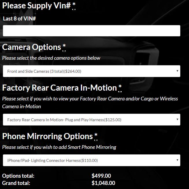

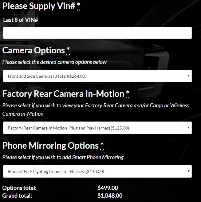

Oh wow... so i specc'd it out on their website with what you describe and its pretty pricey. Is this what you selected?

That doesn't even include the price of the escalade mirrors...

We cut the MVI camera off and then used the MVI wires to plug into the correct pins on the escalade oem connector. Just trial and error to figure out what pins
