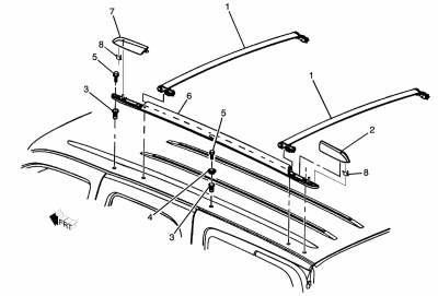

I finally scored a roof rack, end caps, and vent caps from an Escalade for my 05 Denali. The front and rear bolts look the same, but the middle looks different. I didn't remove these, so I'm not sure how they came off. I don't have any extra pieces, so I'm kinda baffled.
My question is this - do the center mounts of an Escalade roof rack mount differently from the center of a stock Yukon Denali?

Yes, the center mount has a little piece that sticks up like a guide bolt. You must have this part to secure it properly. It is a little black piece of plastic if I remember correctly.

GM: 15916756
The part is discontinued but I am sure there is someone that has it. Ebay, a dealer, someone on here, junkyard.

Part #4

261940theo robertson, post: 1506667, member: 78770"]Yes they help secure the center of the rack[/QUOTE][/ATTACH]
