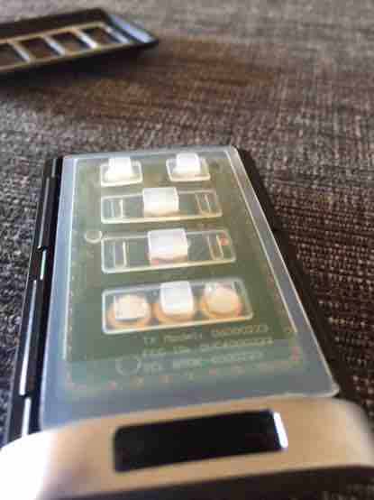

I took my 5 button cadillac remote apart and figured out why the rear glass would not open. There are three contacts underneath the trunk button and it wasn't letting me click the middle contact which is the one that opens the rear glass. Since I don't have power lift gate, I just cut down the left and right contacts and now the middle one can be pressed just fine and works properly.
View attachment 29815 View attachment 29816
I know this is a very old thread but I sn trying to add this style to my 2011 tahoe.
I've purchased this type (5btn) and one with lift gate and rear window unlock....I couldn't get the one with lift gate btn to work at all, I don't have a lift gate...the 5btn will not unlock my rear gate window...I have found some 5btn locally that were used on a Cadillac CTS / STS 2008 thru 2013, new batteries installed, P/N M3N5WY7777A ...Will these work?
