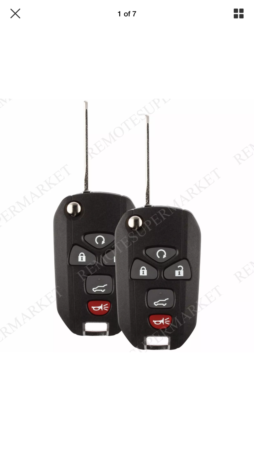

Well, allow me to be mr.guinea pig!
Not a bad product for the money, Both paired seamlessly, Can confirm
1.Not a transponder key.
2. Wont fit between the shifter even half folded.
Its pretty bulky. And feels a little cheapie but i have a Benz flip key in the other hand so its kinda Bias on that quality decision right now..lol

On my 07 tahoe LT will a 6 button fob work even tho i don't have a power lift tailgate?

I'm interested, but I use by back glass alot. So can you pop the back glass? If so, how?
I was a Guinea Pig for the Flip Keys on ebay. Fob works great!

the key wont program so it wont start my tahoe, but even if it did theirs noway it will clear the shifter to get it out of park
So let me get this straight, it's a fob with a flip key but...
A) the key doesn't work to crank the truck?
or
B) it won't work because the key is to large to shift the truck into drive?
or
Correct you are man A&B, it is not a sentry key and if it was it won't clear the shifter by a long shot!

I have a good question, do all the fobs 96 to 13 have the same working frequency? I wonder if my spare flip fob will program to my 96 Yukon :leghump:
