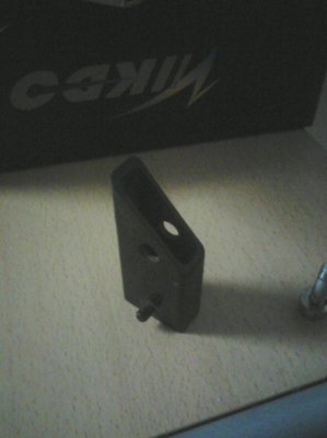

I don't know much about lowering a truck..much less this one.. but I'm managed to change the torsion keys, switched out the springs and grind down the sensors.. Haven't drove the truck cause I don't know where this goes... Is this the shock extender?? If so where do they go??

Thanks man, that's what I thought they were for.. So I got my keys in and springs in and grinded the the sensors... Is that all I need, I don't have any lights on the dash as of yet... Runs good
One more question... I screwed the torsion keys up to factory but didn't like it so I let it down about an inch does it matter?? Can I ride like that?? One more question...is there anything else I can do to the back to get an inch more without changing out anything???
