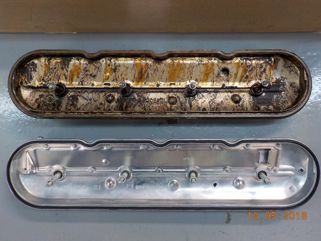

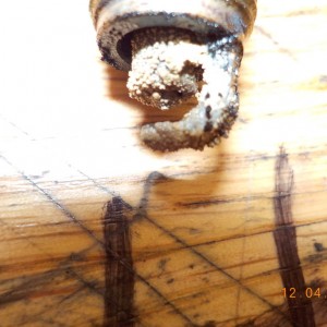

Here is a GM TSB that applies to your vehicle: https://static.nhtsa.gov/odi/tsbs/2014/MC-10114272-9999.pdf
has it been accomplished? if not, then yes the driver side valve cover which is the dirty suction side of the pcv system, can become clogged.
Ask me how I know :(

Ah, that's gold, sir, thanks.
I'm having a little trouble determining if the valve cover applies to me. I have a 2012, which could have been produced after October 2011. I don't know how to find a build date, but coolant hoses have 05122012 printed on them.
LMG btw.
Yikes that's a crusty plug!
The difference in your covers is wild!
