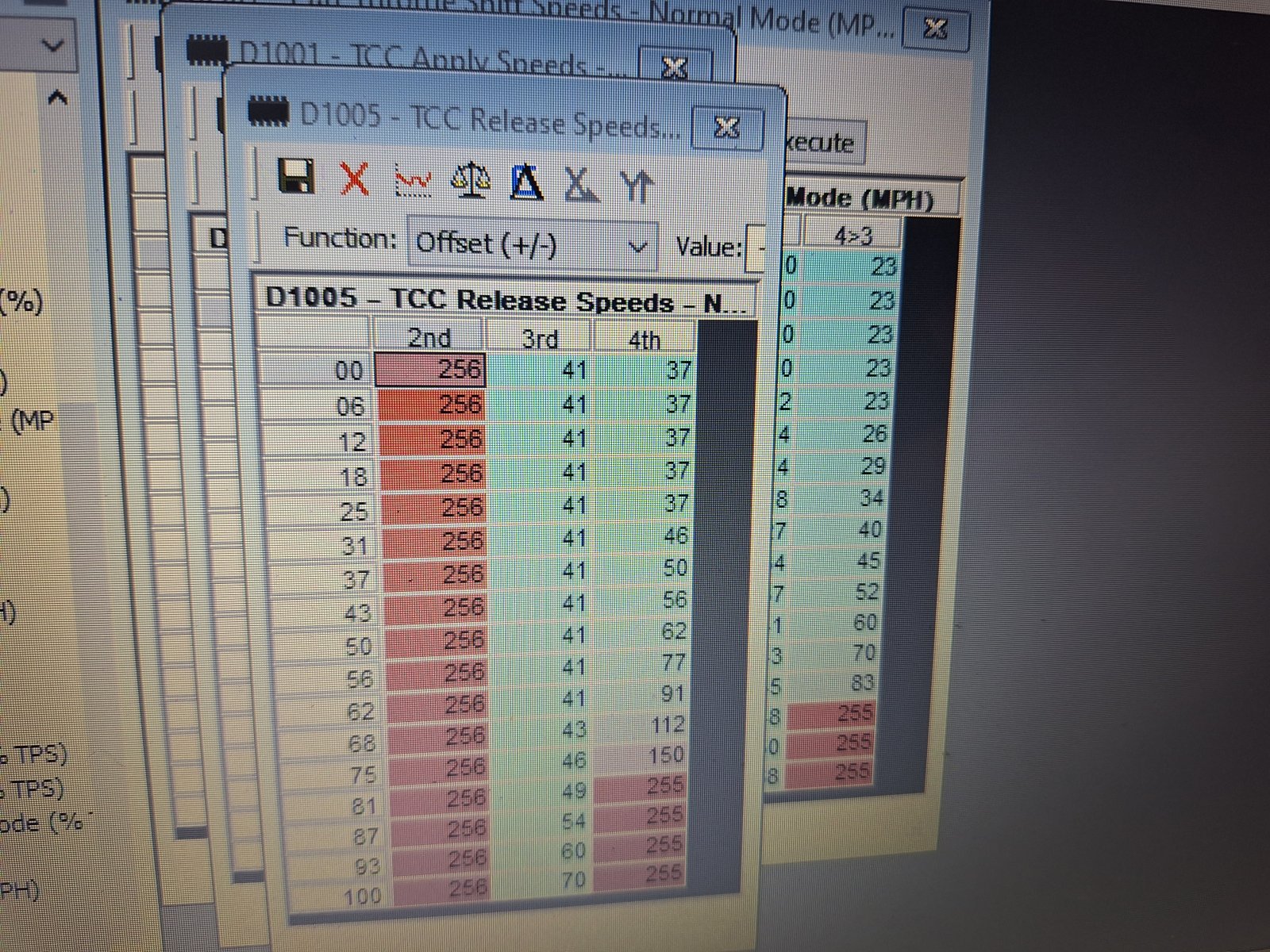

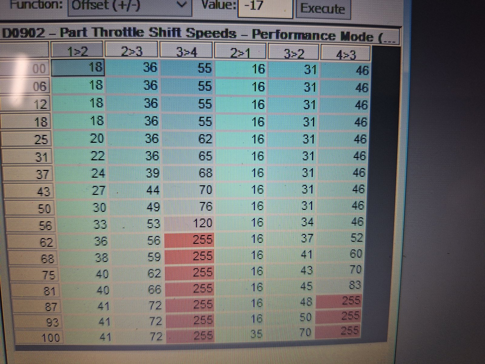

If it turns out it's just doing what the (GM OE) program is telling it to do, the solutions are:
Use Tow / Haul mode to avoid this behavior - assuming this might work
Have pcm properly reprogrammed - this WILL DEFINITELY ABSOLUTELY POSITIVELY work if the gripe is thoroughly understood by tuner
I can look at the program again after work tomorrow, but usually the tow/haul bumps the 2>3 shift pretty high. So it may not even be in 3rd by that time. I always reserve the right to be wrong without checking to be sure though. Lol
Mudsport96
Jun 6, 2020
1,418
2,328
40.923,-89.488. Illinois

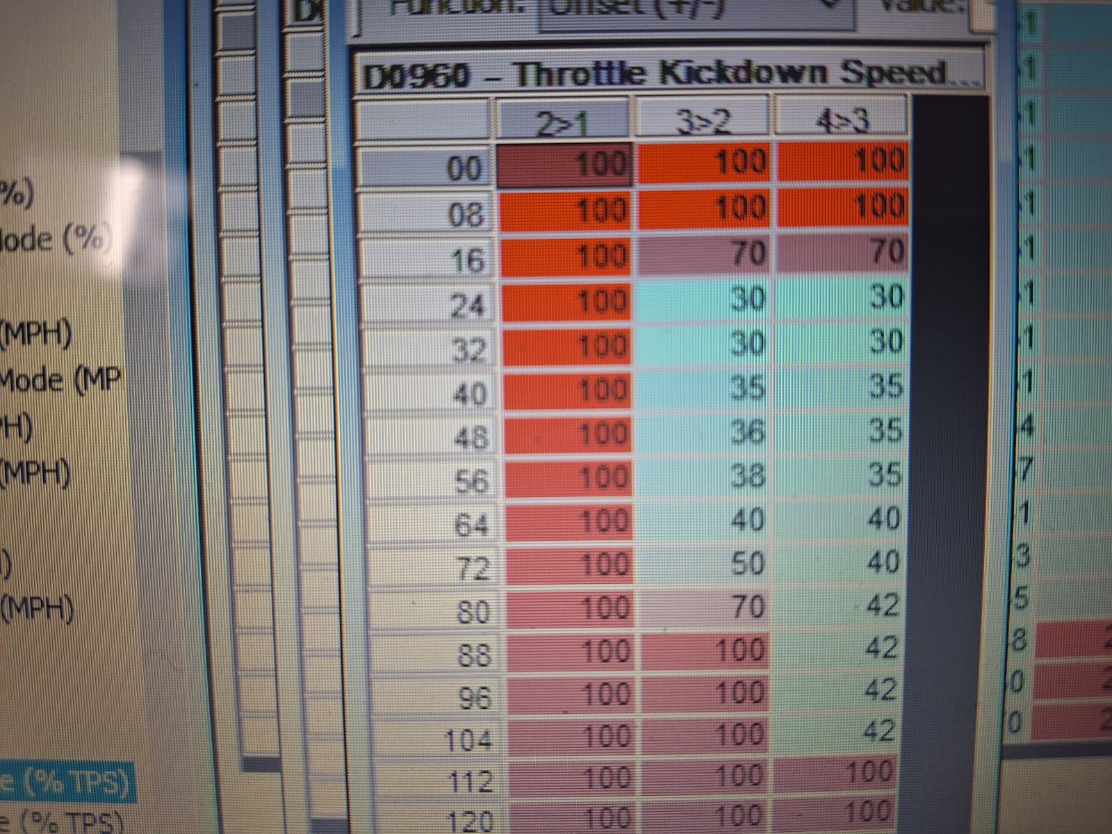

So if you throttle position in 4th gear is 30 percent to 35 percent between 32 and 48 mph it will kick down from 4th to 3rd so that could be it
And I don't think leaving it in tow haul will help, as the 2>3 shift doesn't happen in tow haul until 36mph at moderate throttle. So that will cause it to Rev pretty high. And the converter won't lock till almost 60mph.
