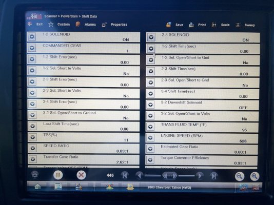

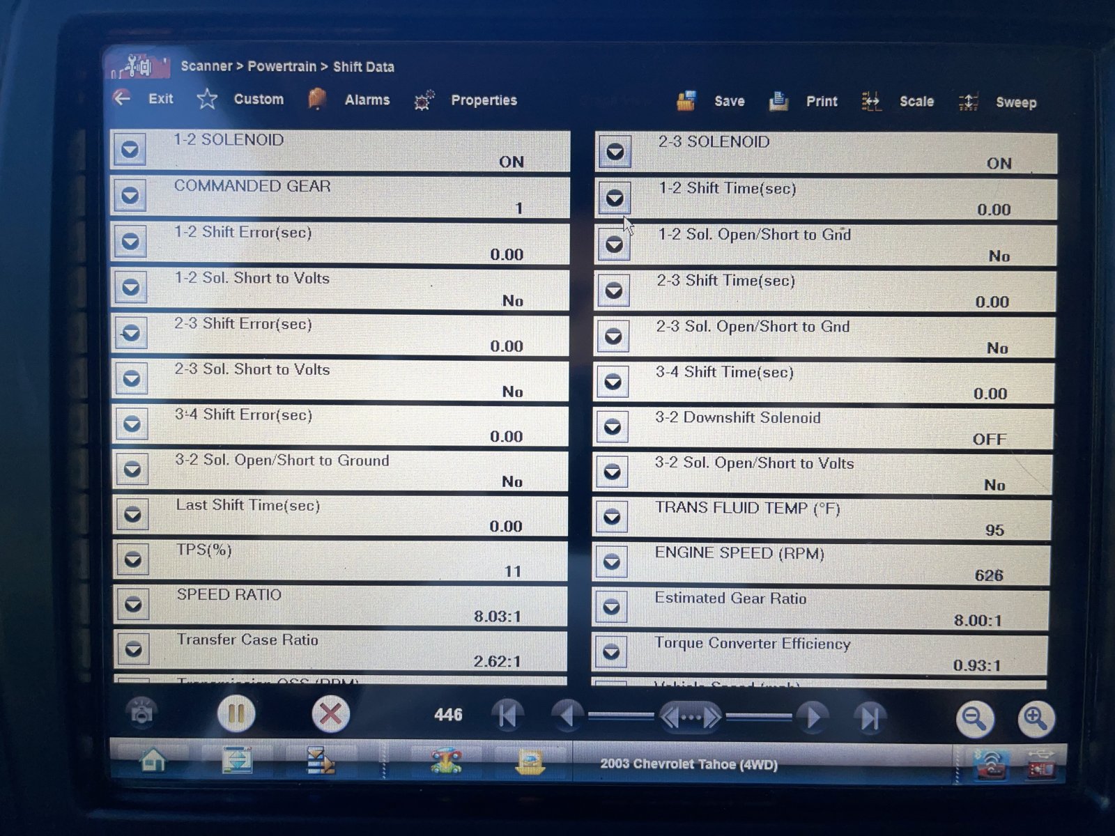

All misfires and/or any residual problems with fuel delivery or induction need to be fixed. The sight RPM rise while accelerating on a grade could very well be associated with that. If the transmission shop took it for a test drive w/a bidirectional scan tool that renders live trans data and saw nothing wrong then I'm inclined to agree there's nothing wrong but I'm basing that solely on what you've shared above. That said, your symptoms could be the TCC locking and unlocking rapidly or the 3-4 clutch pack and/or 2-4 band starting to slip a bit. If that's the case, transmission will need to come out. That sort of slippage or TCC behavior would show up in the live transmission data, particularly in TCC efficiency, shift speed/time and gear ratio for 2-3 and 3-4 shift patterns.
Here's what a typical read out would look like when viewing transmission activity data on a test drive (SnapOn Verus shown in my 03 Tahoe).

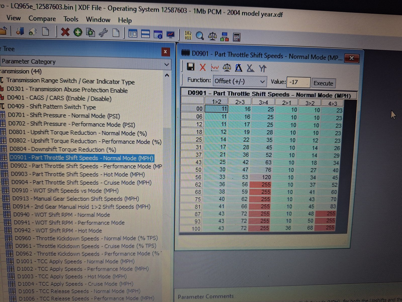

Okay so this is for a 6.0 4l65e vehicle with awd as far as I van tell from the tune. So either an awd Denali or a Silverado SS. Either tune should be close to the other as they are the same basic drivetrain.
I will post pictures, but from what I see in the tune, part throttle 3rd to 4th shift is 35 to 45 mph depending on throttle input ( 25 to 31 percent). Part throttle 4 to 3 downshift is 34 to 40 mph at 43 to 50 percent.
Converter lockup in 3rd is 43 mph at 6 to 25 percent throttle and in 4th 40 to 42 mph at 6 to 18 percent throttle.
Converter unlock in 3rd is 41mph from 0 to 62 percent throttle. And in 4th unlock is 37mph from 0 to 25 percent throttle. So it seems to me by the tune. The speed you are having this issue lays in the no man's land of the speed you are going in 4th. I would stick it in 3rd and see if it still happens.

thank you for the information. If I keep it in 3rd and it doesn't do the same thing, then you're thinking it's the TCC lockup issue?
Shouldn't do it. And it really isn't an issue technically, it is just doing what the program is telling it too do.
If you could get a video of what you are experiencing, we could better diagnose this.
