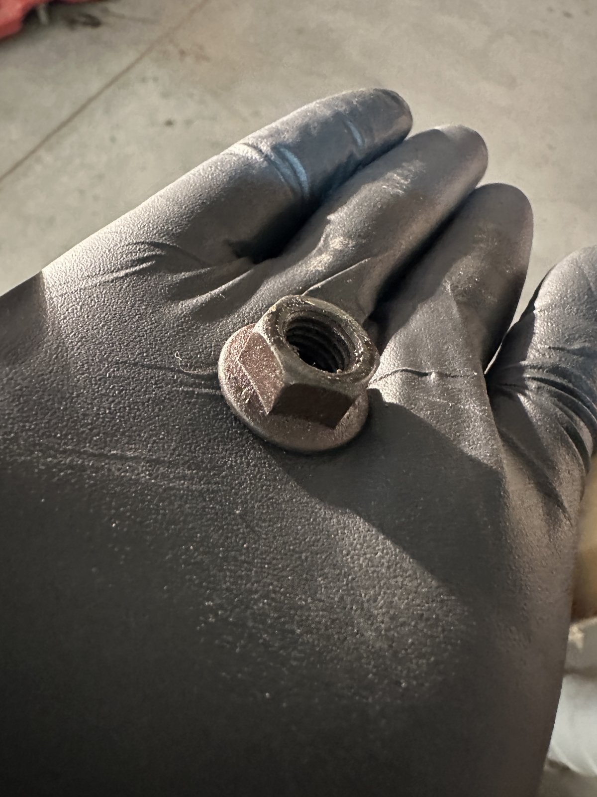

Correct on the starter gear making the noise. Guessing only remedy is to replace the starter. Is it harmful to run the motor with that noise (ie premature wear on flex plate teeth?).
Interestingly, I popped the bell housing inspection cover and this nut fell out. Initially thought that is what was making the noise but apparently not.

I mean you’ve been driving it up until now and it’s been fine but when you understand it’s the teeth of the flywheel grinding against the teeth of the starter it’s not a great picture.
Interested to hear what that bolt goes to, I don’t have any experience working on that side of the motor
