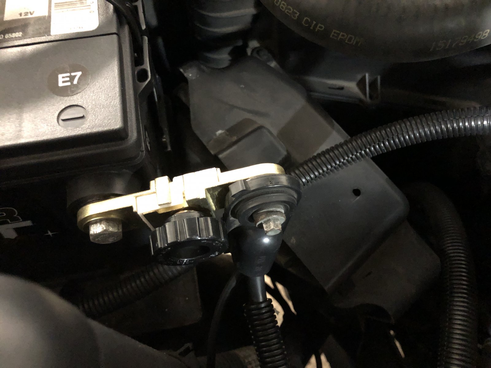

The tender I use analyzes, cycles the battery by discharging and recharging, de-sulphates etc. You leave the battery connected to the vehicle. I learned about them from riding Harleys which are stored 6 months out of the year here and the batteries are a ***** to remove. I use one on my bagged truck because it sits for 4-5 months in winter. It’s better for the battery than disconnecting it and letting it sit plus all my settings and computers are kept up. I have a connector hard-wired in the truck and the tender just plugs in.
https://optimate1.com/om5vm/
