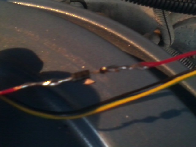

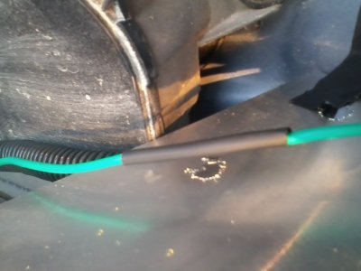

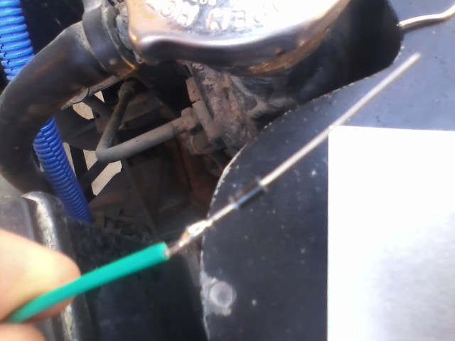

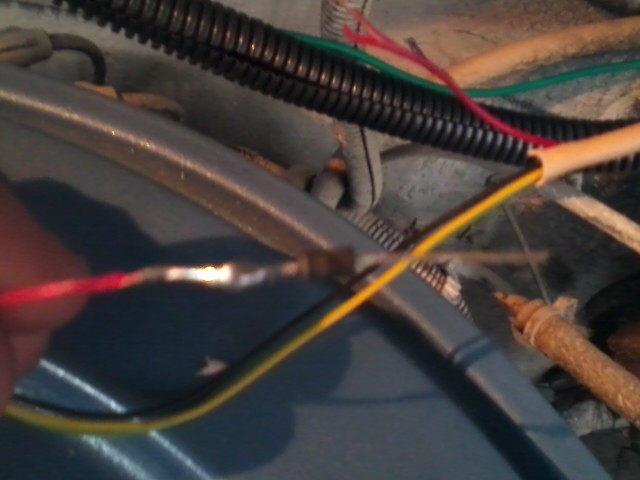

well all worked out as planned! got the diodes soldered in and it works. now i can use em when i flip the switch and they come on in reverse automatically. took some pictures but they arent that clear. are from my phone. the green wire is the one taped from the reverse lights ill add the pic of where in a lil bit. the red is the signal wire from the switch

green in the wire in the frame a spliced into.

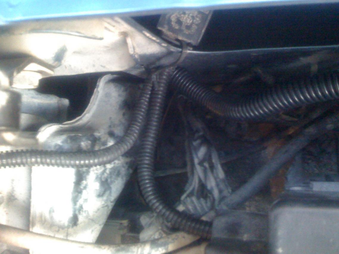

the other are of the 4high whree i mounted it over by the aux *** box on drivers side. the diagram is how i did mine
