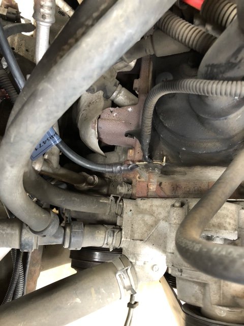

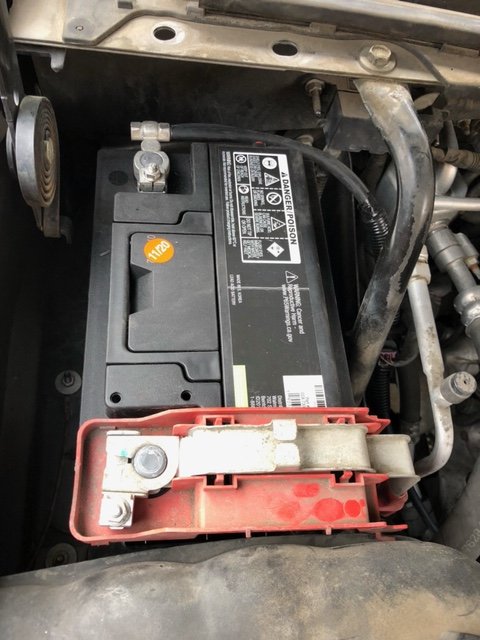

Here's the new battery with the new negative battery cable installed. The positive terminal looks pretty clean.
I replaced the mega fuse this morning just for kicks:
And here's a pic of the engine ground (the contact is cleaner than it looks here):

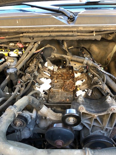

Following this one for sure!!
Holy mackerel!
I had the same issue when I pulled my intake off both foam seals were destroyed I think by a squirrel because there was a peanut shell under there as well. So it’s not unheard of that is a favorite place for animals to dig into on these rigs.
When I reinstalled the intake I left that foam ******** out of there.
HOPEFULLY that shorted battery did no harm to the sensitive components. Did you check all your fuses and relays?

Here's a pic of the nest (maybe it was a squirrel?):

Did you snug up those valley cover bolts while you were in there?
Ugh, no I didn't do that. I didn't see any oil leaks up there, so hopefully it's fine for now. Anyway, taking the intake manifold off turned out to be easier than I thought it would be. Only real problem was getting the fuel line disconnect to release. Had to buy three different tools before I found one that would work.

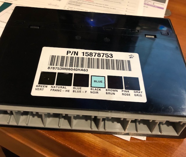

Success! I went ahead and replaced the BCM this evening and it started right up. Everything seems to be working fine now (engine cranks over and starts, dome lights, radio, door locks, ect).
I decided to buy a used BCM that was programmed for my VIN instead of trying to program it myself with the tech 2. For no good reason, I bought it from Deering's Sales in MN (320) 403-4000. They answered all my questions over the phone and sent me a programmed BCM with matching P/N within a week. It cost $195 including the programming and shipping. You could probably get one for ~$70 on ebay, but you would have to program it, etc. and I was getting tired of having to borrow my son's car. Case closed.
