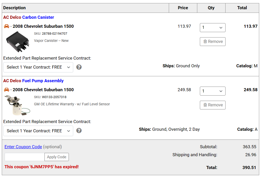

Fuel gauge could be something as simple as a bad harness connection above the tank or the float is hanging up on carbon pellets or the float isn't floating anymore. Any way you slice it the tank needs to come down to inspect things.
With this task at hand, it's just time to replace the fuel pump and the carbon canister. It's the labor to drop the tank that necessitates doing the job 100% so you don't have to pay for the labor again.
Lucky you OEM pumps including the sender and a lifetime warranty are $249 at Parts Geek right now. Expect $4-500 elsewhere. Check with the installing shop to see if they want to order it or if they'll let you bring it in so that the labor will have a warranty too. 2nd, that carbon canister that likes to fill the tank up with carbon pellets. Have the tank swab'd and cleaned along with the lines blown out for possible pellets in there. Call it done for the next 100K miles.
Sorry, looked for online coupons for free shipping but couldn't find any. You may have cheaper tax and shipping rates.
