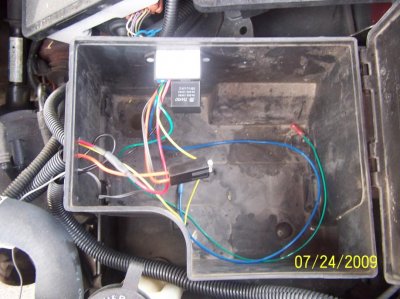

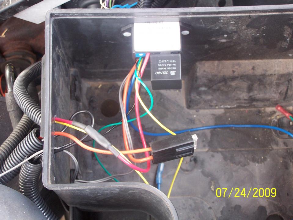

I would go with two 16" fans I currently have one it works good but I dont run an a/c system. If you want all the comforts and a cool running motor go with the dual 16" fans. As far as wiring my local advanced auto had a relay kit for 25 bucks it came with a temp sensor that installs in the radiator. I have mine set (you can adjust on set with the relay) to come on when it reaches170 temp when i get a second fan I will set it for the a/c relay to activate it and as a back up for high temp while im sitting in traffic. The instructions were very easy and if you get lucky your auto store manager is a gearhead like mine and has done tons of stuff to his car. I also bought the fan from advanced mainly because they carry the replacement motor so I dont have to wait to order one just go in and pick a new one up. All parts were Hayden no complaints so far. I mounted my relay in the nice storage box that gm provides us made for a clean install and relay stays dry! Let me know if you want pics.

I installed the relay in the black box on the drivers side. I will get pics for you keeps it nice and dry and out of sight.....

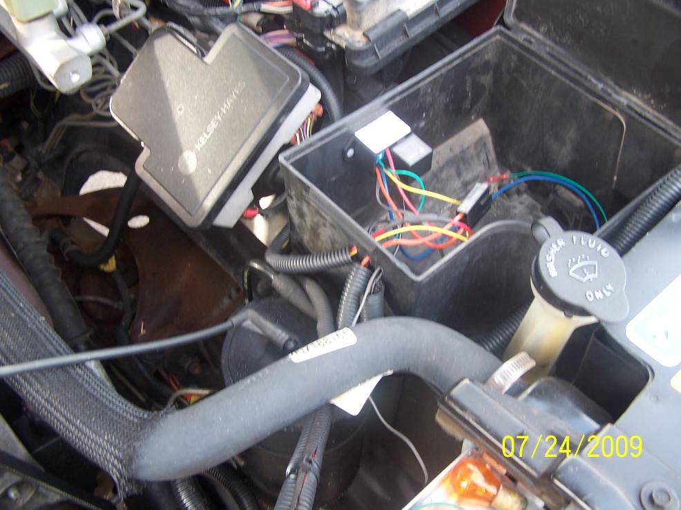

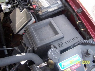

Here are the pics. Hapyspaz and myself did the rebuild on the truck he had the idea to put it in the tool box. I did a test fit to line everything up drilled the spots and used wire loom to hide the wires in the engine bay. There are two extra wires for the a/c relay so far everything is great turned out to be a great spot. As you can see left extra wire in the box looks a little messy but I plan on a second fan so I wanted room to play.

damn. thats where my second battery is. lol. might be the time to get my battery box built so i can accompany it with that relay..
