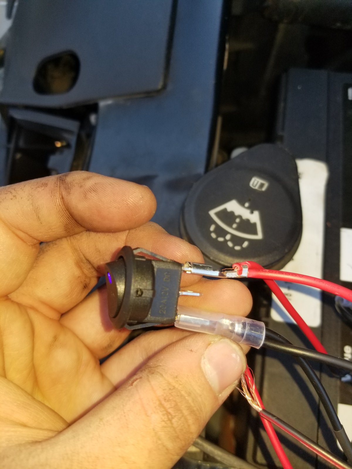

If you know which wire is the ground that needs to go to the PCM, that would be your relay ground to run through the switch.
Ok thanks, then I just need to ground the switch and I should be good?
JPVortex
JPVortex
Jan 13, 2022
494
357
Doesn't matter if you're controlling the relay. It takes the current, not the switch. Think about it, could the ECM circuit handle that current? Nope. Hence the relays.
That's true, thanks for the lesson in electrical haha. I really know nothing about electrical lol.

you really need two relays, one for each fan, pretty sure i mentioned this in a earlier post. you can power both relays from one switch and with one split power supply lead to the relays.
JPVortex
JPVortex
Jan 13, 2022
494
357
The stock fan wiring has 3 relays, which is what I'm doing. All I'm doing is manually cutting or giving the circuit ground which is exactly what the PCM used to do at one point.
